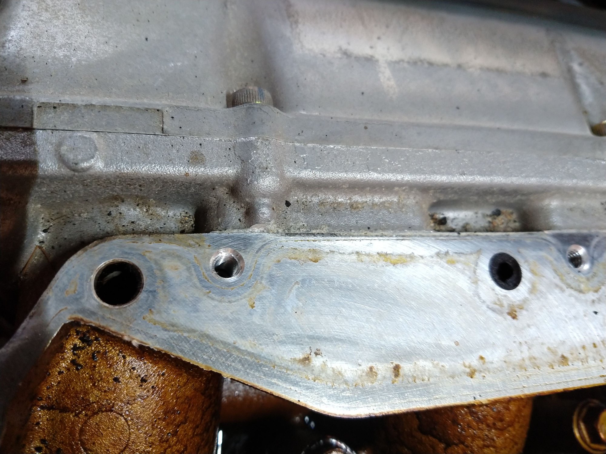

Haven't looked at that yet. It is less than 3 months old but worth a shot. I did find this though and cleaned them out...EGR ports?
Left port clean..right side is almost completely clogged.
