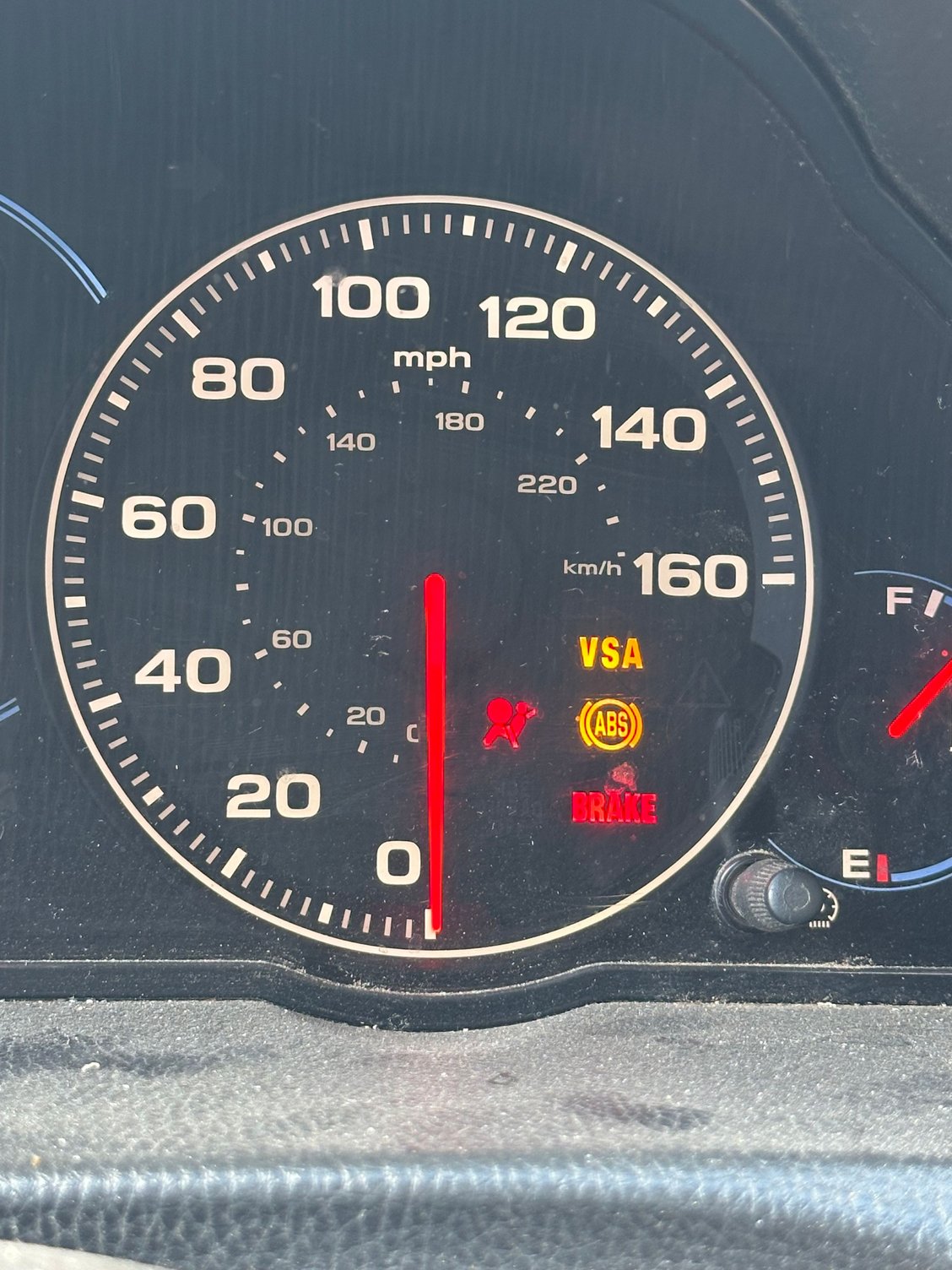

I replaced all 4 brake rotors, brake pads, and bled the brakes. It’s braking perfectly fine, but for some odd reason that “BRAKE” light is still on! I read online that if you replace the brake light switch it should fix those lights. I bought a brand new brake light switch and replaced it, and the lights are still there. I bought the car like this, so I couldn’t tell you how long they’ve been on. Please help!

Check the fluid level in the brake reservoir - if it's low, the BRAKE light will come on. If the level is ok, maybe the sensor is bad. I think it's at the bottom of the brake fluid reservoir.
