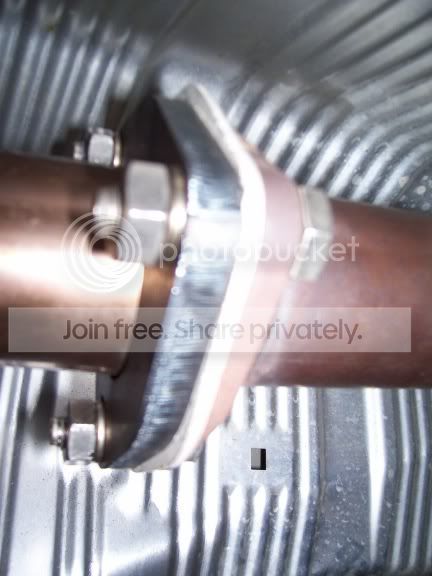

I have this rattle too. When I installed the cat and header, I had to pull the exhaust foward maybe half an inch or so, so that it can mate up and I can bolt it together. I wonder if the rattle is caused from that. When it does rattle, I notice that if I step on one of the exhaust tips it rattling goes down a little bit. Did anyone else have to pull their exhaust forwards a little bit when installing? I have an 06 BTW.

i don't clearly remember, but its either header or cat that is shorter than OEM length and it pulls the exhaust forward.

This is fairly common. The gap was obviously less with the 2 NAPA exhaust gaskets, but yes, I too had to pull mine up a very little bit.

Well, I got the rattle to go away. What I did was unbolt the entire exhaust. I took off the comptech header, RT cat and the whole exhaust system. I assembled it on the floor and made sure everything was nice and snug and the top bolt going from the RT cat to the exhaust a little loose. I was able to put the header and RT cat together better since I didn't have to pull anything and bolt at the same time. Then once the entire exhaust system was assembled, I lifted it back onto the car and bolted the headers up an put the exhaust on the hangers and so far, no more rattle.
So the source of my rattle wasn't my header, it was the RT Cat not being bolted to the enhaust all the way and rattling since the flange o the RT Cat was the free floating kind.
This is what I ran into too. My problem was caused by me trying to install a gasket between the cat and exhaust that was too thick. With the a/c on the car exhaust was rattling like crazy. When I went to check out the problem, I found out I could freely wiggle the cat and make it rattle. Some of the people with rattles might want to try inspecting the exhaust. You could even go to Midas and have them do a free inspection for you.

I took my car to meineke and had the car on the lift. I discovered that the header exhaust hanger ripped apart. The metal hanger on the header looks like it was hanging way too low for the rubber exhaust mount and it caused it to break apart. The tech at Meineke said they have to bang that metal hanger on the header up a little. So I ordered a new one, and i'm just waiting to put it back on.
