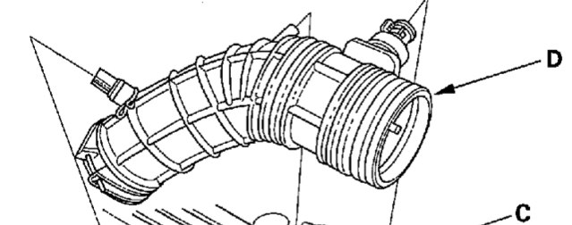

Hey guys, I know there is a DIY on here about how to change the starter but I have some general questions in regards to removing the intake manifold. Somehow when I was removing that tube connected to the throttle body, it ripped in half so now I need a new one. Its the tube in the picture below. I had a question about removing the stupid lines that are connected to the intake manifold. Is there a special trick to doing it? They are so freaking hard to undo and Im worried that if they are this hard to take off they are gonna be super hard to put back on. Does anyone have any tips at all on how to remove these lines? BTW like the guy in the DIY as soon as I removed the two lines pictured below, anti-freeze came spewing out everywhere. I'd really appreciate any tips since I don't have a car until the starter is replaced

and does anyone know what the name of that tube is and where I can buy a replacement?

You ripped the air intake duct? It's available from Acura or possible car-part.com to find a used part.
The hoses can be difficult. After reposition the clamps, use pliers to first enable a little rotation of the hose on the nipple. Once it will rotate, you can pull and twist to remove. There is a tool to assist w/ pulling available at auto parts stores. Sometimes you can get a screwdriver and pry the end of the hose to get movement started.

Yeah I guess thats what I ripped. It seemed to be dry rotted anyway so it may be good to replace it. Have you ever replaced one before? I used a flat head screwdriver and a rubber mallet to get most of the lines off but you see the one under the throttle body? That line is so hard to get off. I appreciate the advice and I'll try that out. Does anyone else who's done this have any tips?
