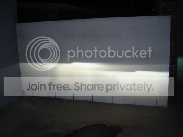

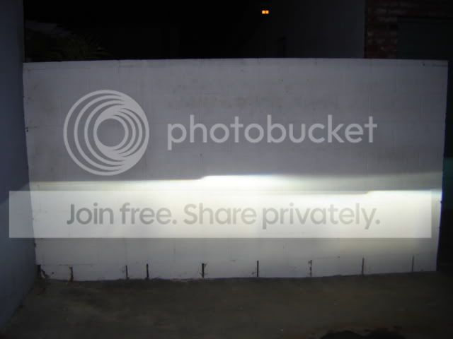

One of my headlights is brighter than the other. Is there a way to correct this? I have not made any changes the headlights. Any help will greatly be appreciated. Thanks.

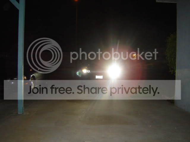

I'll take a couple of pics tonight. My observation is from both, when I'm driving the car and also when I'm looking at the car head on. The driver's side light is much brighter. I also notice when I'm driving that alot of the on comming traffic covers their eyes because they get blinded by my lights. Alot of drivers flash their high beams at me to signal me that I have my high beams on, but they're not. Whenever I would pick up my girlfriend, she said she knew it was me comming because the driver's headlight was brighter.

It's unusual for the driver's side to appear brighter. It should be aimed lower than the passenger side so it will appear darker. Take a shot with your lights aimed at a wall so we can see the beam pattern. it should look something like this _____/----------

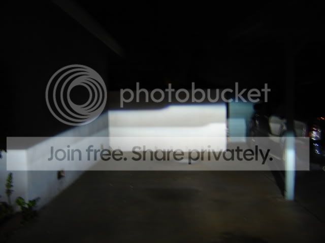

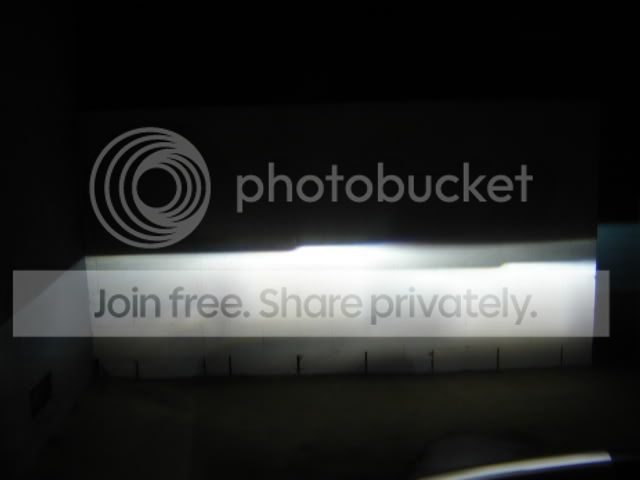

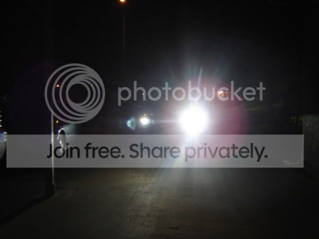

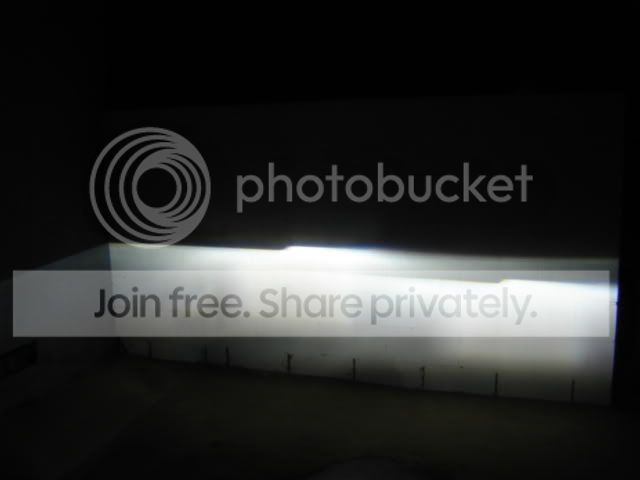

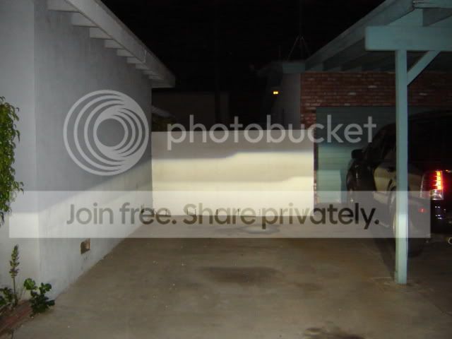

OK guys, here are the pictures! As you can clearly see, the drivers side headlight is brighter than the other.

to me, neither headlights appear to be "brighter"
i believe you need to adjust the height of your driver side headlight slightly lower than the passenger side. Otherwise you might be blinding oncoming traffic

My Eyes says that your bulb looks ok, but the height on the drivers side HID is higher than it should be = Lower the drivers side HID

your headlights are seriously unaligned. did it come like that? do you see how you have two distinct cutoffs? you need to adjust and lower the driver side headlight
here's info: http://https://acurazine.com/forums/...ad.php?t=21758

Yeah, it looks like more of an adjustment problem to me.

Thank you so much for the help guys! You guys were right! All it needed was some adjusting. Thanks again!
