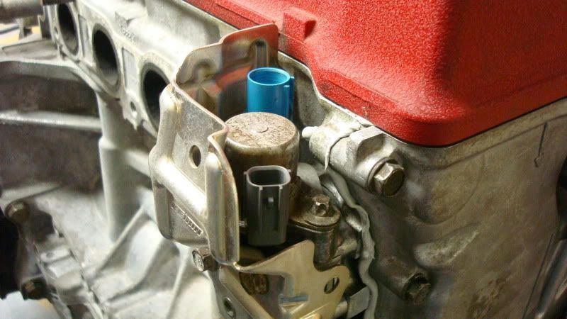

The fix for my VSA light was the VTEC Solenoid. It's right behind the head on the passenger side.
