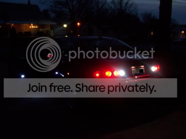

Here is a close up of one plate light. These are natural white instead of cool white. Notice there is not as much blue as cool white.
For an even better feel for the color, here is a pic of natural white LEDs in my reverse lights. You can also see the door and plate LEDs. The light shining on the ground from the door light looks way darker in this picture than it really does in person.
Hopefully this helps you out.
