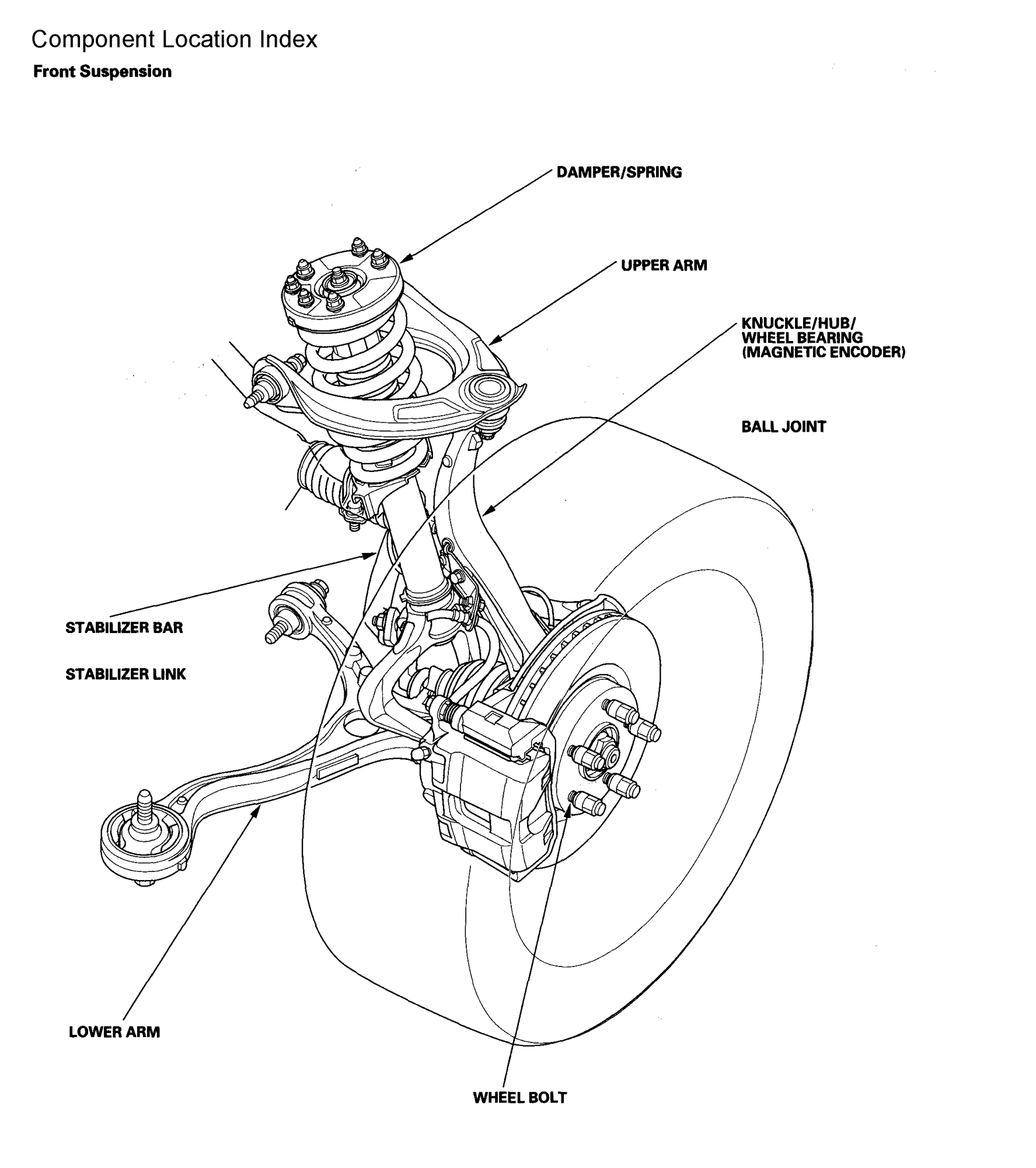

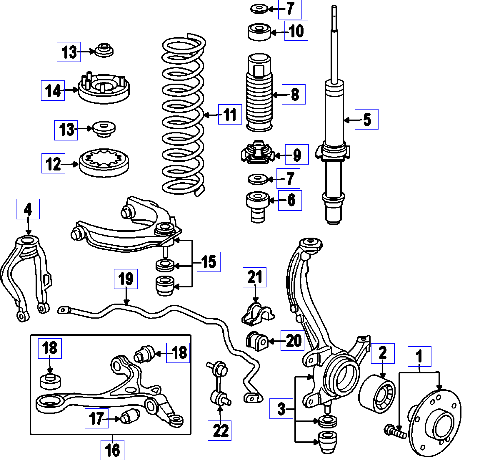

As for suspension... here are the the different "pieces" of the front:
  • Upper control arms with upper ball joint <--- get one with an adjustable ball joint so you can fix your toe alignment
  • Lower control arms
  • Swaybar links
  • Swaybar bushings
  • Coilovers (spring/damper assembly)
  • Loaded knuckles <--- this has the hub, bearing, and lower ball joint already pressed in. Huge time saver. Otherwise, you can reuse your existing knuckles and possibly the bearings if they're ok, but deff replace the ball joint.
  • Strut fork <--- this is a solid piece of stamped steel with no moving parts, just clean it up and reuse it.

Thank you very much! Can you tell me which of these front “pieces” are parts that wear out, or bushing I should change? I ordered KYB struts for the front and want to change all of the wearable parts to hopefully not have this headache for a loooong time. I also ordered the OEM Upper control arm.

Depends on how good or bad the roads are in your area.
Where I live, paved roads are so bad you might as well be off-roading, and almost everything is a wear part. Struts are basically 100k mile parts and it's a given that they'll wear out by then for example.
For my Accord suspension rebuild, the strut fork is literally the only part that I'm reusing. Everything else is getting replaced. Car has 145k on it and with the exception of a ball joint the suspension is stock, and I can really feel it.
In areas that have competent DPWs and well-maintained roads, things like wheel bearings very well may outlast the vehicle, and you can get 200k+ out of other parts.
The lower ball joint generally takes the most abuse from potholes etc. and is one of the more critical wear components. Control arm bushings also wear more with mileage because the rubber rots and cracks. I wonder if areas that don't have road salt might be less prone to this issue but I only work on cars in new england.
Also consider that it's less time and work to replace everything in one sitting vs replacing parts as they fail. And failing parts often put more stress on other parts causing other premature failures.
