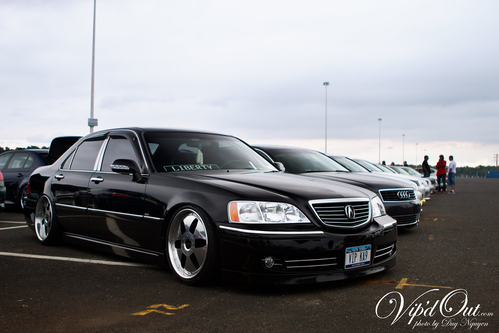

^I found some on google!
Old Jul 3, 2019 | 06:18 AM
https://www.stancenation.com/2013/01...able-acura-rl/

[QUOTE=justnspace;16447805]https://www.stancenation.com/2013/01...able-acura-rl/
thanks for sharing. A lot of those I seen on Google as well. I was just hoping someone would pop in here and show theirs so I would know the offset they used.
Old Jul 3, 2019 | 10:27 AM
From experience, those are very low offsets.
in the website that I provided, the article states the fronts are 19×9.5 +8 ...and the rear is 19×10.5 +0
VERY LOW offsets. which he countered with camber, as to not to rub.
