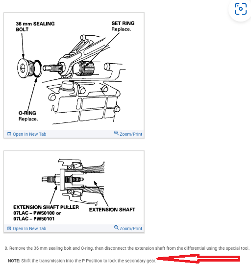

This is all I can find that shows utilization of the special acura tool 07LAC-PW50101?
It states to 'shift the transmission into the P position to lock the secondary gear.'
It looks like that special tool is the key to success??

Hey. In short, you wanna try to remove the shaft using the tool. You can tighten with a bit of force, but be careful. I broke mine in the ext, shaft. If it feels like you are using too much force, you can put the trans in neutral and rotate the front passenger cv axle/wheel about 20 degrees to try and get the snap ring into position. It is actually somewhat similar to replacing a cv axle concept-wise. Oh, and I wouldn't use PB-Blaster or any other penetrating fluids since it would likely go into the transmission case and the fluid. In fact, I suggest you change the trans fluid before you even start the vehicle again and do a 3x3 flush within 35 miles of putting her back on the road. Penetrating fluid and transmission clutches do not mix well.
