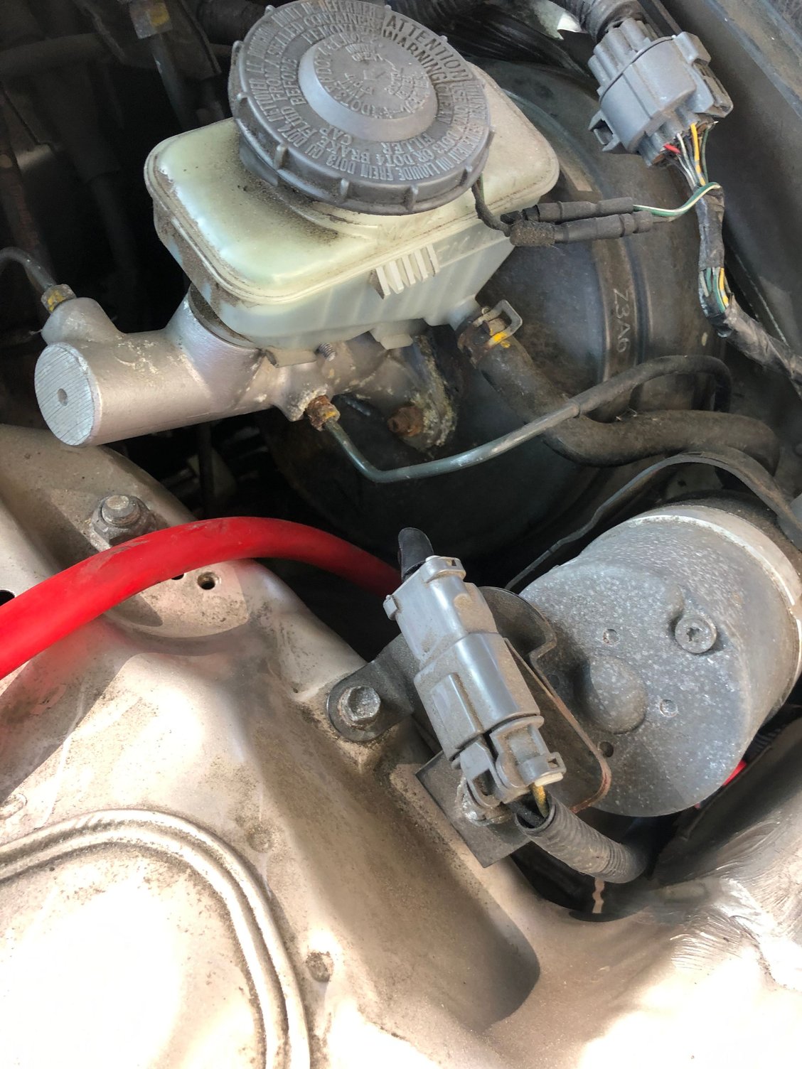

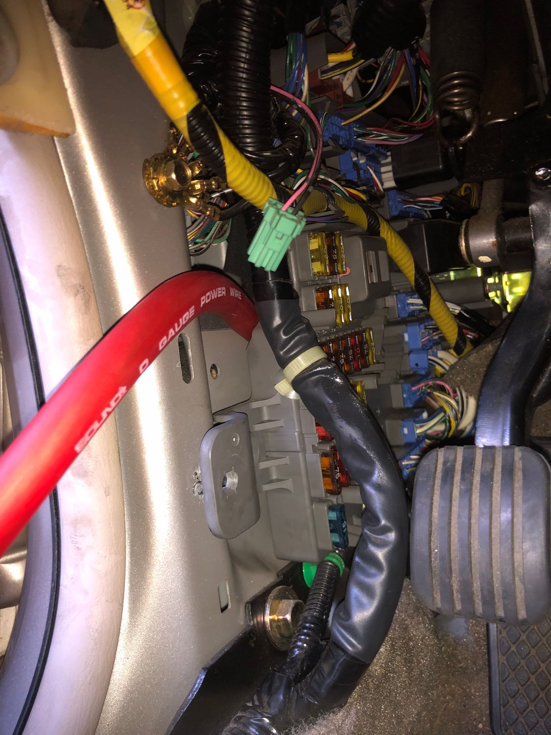

Since, I figured all this out ( and it worked ) I went into the next part of running in the 0g power wire for the system.
THERE IS NO ACCESS THROUGH THE FIREWALL.
I searched high and low couldn’t find one thing that worked, so I kept looking and noticed that the main wire harness runs through the driver foot well so I removed the driver fender and BOOM grommet access.
Now, it may be a lot of work getting it through, but the knowledge that it will be in a safe place and not having to run it underneath the car ( my plan b ) was awesome.
I’ll link pictures below.
I haven’t finished it just yet because I figured fenders off start doing HID fog conversions and all led blinkers, but that’s tomorrow’s plan.
when the system is completed i’ll update on where i grounded and all that good stuff. Hopefully this helps you guys!!
