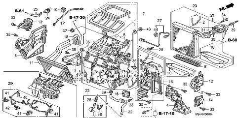

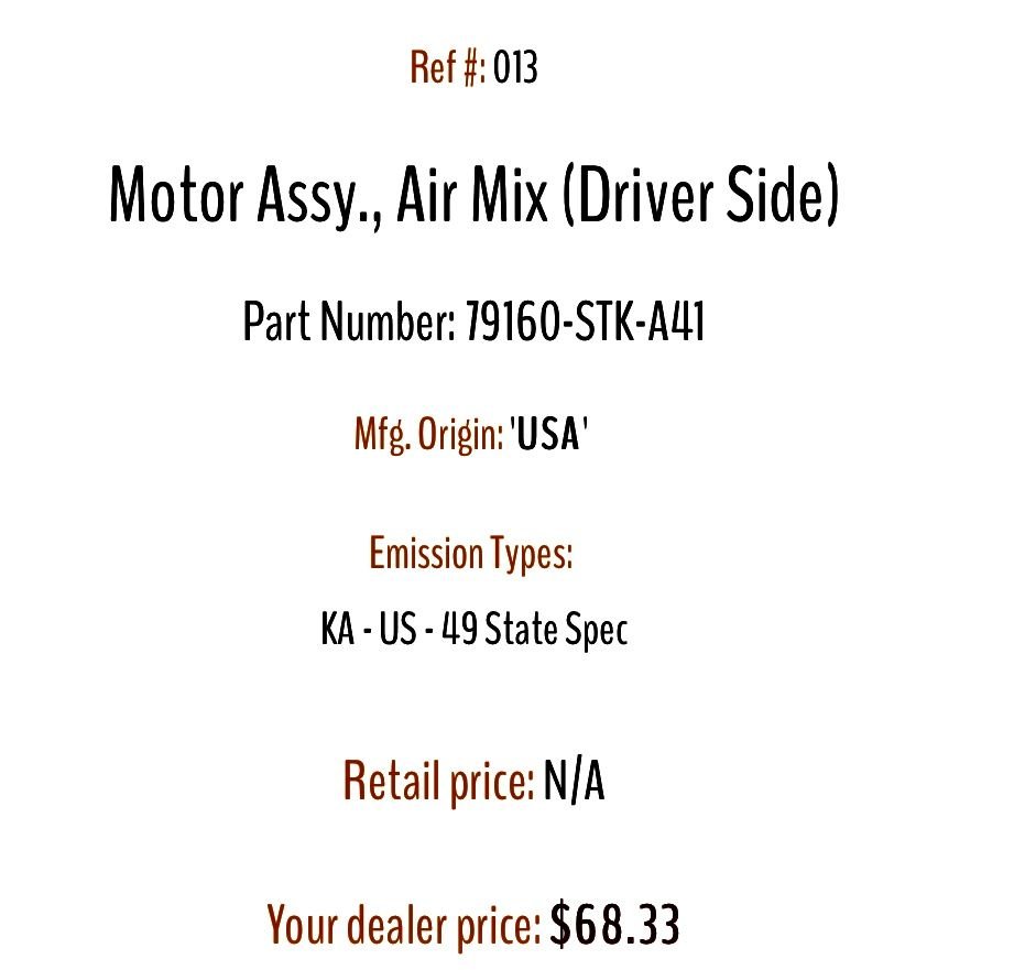

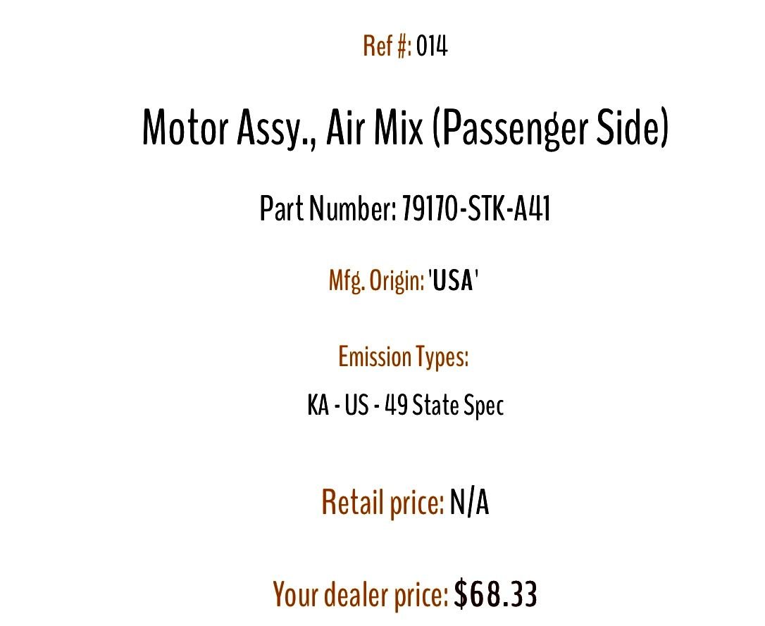

I hope this helps you with your install 🙂.
You might need this part information ℹ️.
You might also need this parts information ℹ️.
