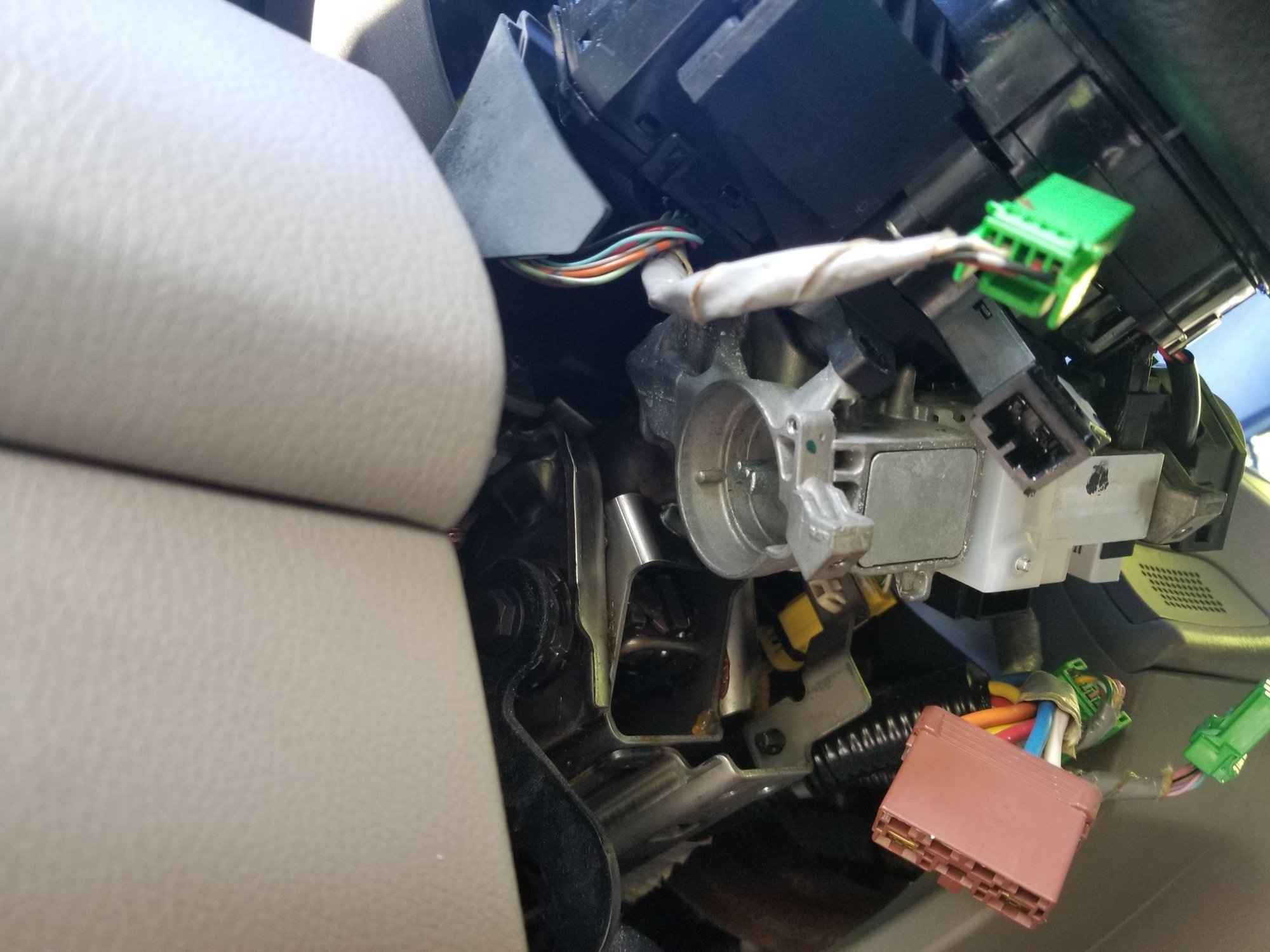

Hello, I've already posted a thread regarding this topic but I'm circling back because it is unresolved. I've received some very helpful feedback from other members. I'm without a car and getting pretty desperate but can't afford to pay a mechanic so any advice forthcoming would be MUCH appreciated. Here's the issue, how I troubleshooted it so far, and what has been recommended.
Issue: ignition will advance to accessory II position, key turns fine, power lights up and all systems are operative, advance to start and nothing. I don't hear any clicking, hum, etc. as I've read may indicate a problem with the switch "relay" (part no. 35130-SAA-J51).
Action: I replaced this item, generic version for $20, and installed it without any issue. Car fired right up. It worked for 2 days and then returned to previous issue, key advances, starter doesn't engage.
Action: I replaced the generic part with the Honda OEM and nothing changed.
Recommended: check battery terminals, disconnect bluetooth module (could be draining battery), replace the entire ignition assembly, take it up the rear from the Acura dealer.
I know that I can purchase the entire ignition assembly used for $169. It will have to be reprogrammed which is at least $100. However, I was wondering if I should first replace the immobilizer (part no. 39730-STK-A01) before purchasing the entire ignition assembly??? I believe this also would need to be reprogrammed. Other members have suggested it may be an electrical issue (battery cables, bluetooth module draining the juice, etc). The battery terminals and cables look tip top. Is there a way to check the amperage going to the starter and would this eliminate a battery issue? This issue has been going on for over a year. Typically, when it happens, car doesn't start, after waiting a sec or two, try again and the car starts. I'm wondering why the first time I replaced the switch "relay" it worked for two days and then stopped. Please share any ideas. Thanks in advance (if you read through this entire thread that is)!!!
View of ignition assembly
starter switch (removed) location
Part replaced 2nd time with the OEM.
Generic part that worked for 2 days.
