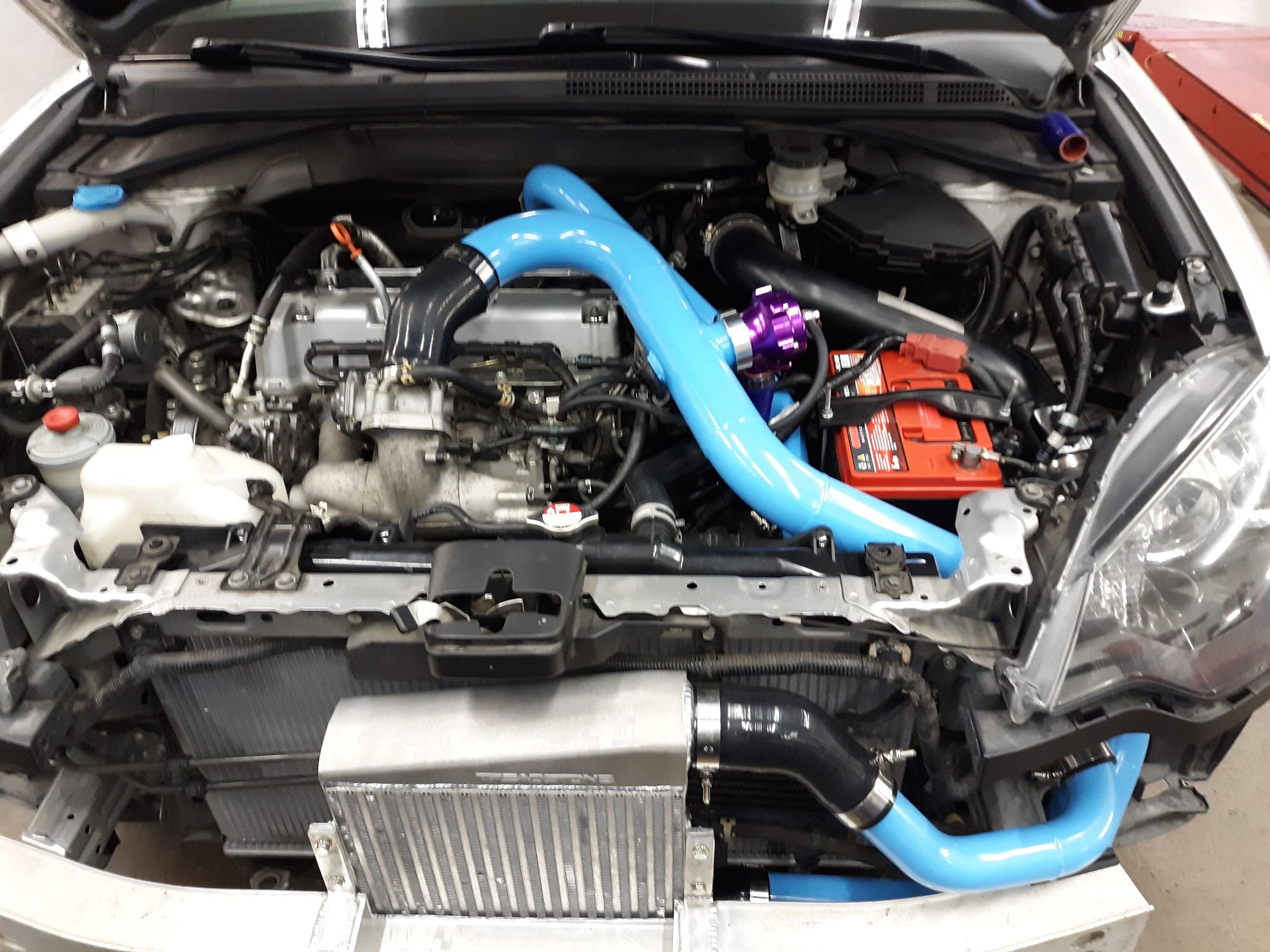

What's up ladies and gents.
Over the past 6 ish months I've been collecting parts to mod my 11 RDX. I'm currently waiting on my ATLP exhaust which I'm slightly starting to get upset about as HeelToe told me it would be shipped out around the end of November, and yet I can't get a response as to an updated time frame. It's literally my last piece for this build, and as you all know, if you don't do it all at once with these cars, you don't do it at all.
Mods are the tried and true list aside from the intercooler, which I spent entirely way too much on but hey, I'm excited about the outcome anyway.
- CP-E intake
- DW 800cc injectors
- DW 300c fuel pump
- RV-6 down pipe with cat (I still need to pass emissions here in CO and I don't want to take it off and put the factory down pipe on every time I need to do emissions) also had a third O2 bung welded in for a wideband.
- ATLP exhaust (I'm going to take the single tips off and try and find a staggered dual tip to put in its place so it fits the rear bumper better)
- Completely custom front mount Treadstone intercooler with custom piping (with a port for factory emissions lines that run through the bottom of the blow off valve from the factory)
- TiAL 50mm blow off valve with 11 psi spring as that's what is recommended for these cars. Will still be recirculated
- AEM boost/vacuum and Wideband gauges mounted on top of the steering column (yes these do slightly impede the visibility of the speedometer, but I can still see absolutely everything else on the dash, and I can still see from 20 mph up to 140 mph and let's face it, 20-80 is were 99% of normal driving is)
- Tuning through E-tunez and Hondata FlashPro which I already received a tune from Steve a week ago so I'm 100% ready to flash when I have the parts on the car.
Next year I plan on doing some 19" wheels with a lower on BC coilovers but until then, this is where it stands.
I'm extremely happy with how the intercooler and piping came out so here's some pics of that. They are quick pics of before the blow off valve and boost sensor bungs are welded on. There's still a lot of airflow on the very front of the car and I'm not racing it so I'm truly not worried about its placement in the least bit. It's also roughly 80 cubic inches larger than the factory one so even the small amount that is slightly blocked by the crash beam won't hurt it in the least bit. I also removed my AC stuff as, call me crazy, but I never used it. The battery had to be rotated as well because I seriously didn't want to relocate it, so it's 100% custom battery tray done by the same guy who did the piping.
I'll try and update as I receive the last part and continue the tuning process.

Finally received my exhaust yesterday, thing is absolutely beautiful. I also went and picked up my downpipe as I got it ceramic coated by a local place here, it turned out amazing. And i also got the call that my intercooler piping is done at another powder coating place so I'll be going to get that likely tomorrow during lunch.
In all, I'm hoping I'll be throwing everything on on Monday as i am now 100% ready to go with parts and tune.
Old Dec 13, 2018 | 06:39 PM
WellHellWtvr215's Avatar
Joined: May 2018
Posts: 89
Likes: 16
And the final product ladies and gents. 5 hours of straight work and she's running like a dream.
For those of you hesitant on E-tunez, I literally can't say any better words about Steve. All the mods being put on at once, I flashed the ECU with the base tune he sent me, held my breath, and she started up quicker than she did in stock form. No check engine lights, A/F showing 14.9 at idle right now, and running like an absolute dream.
All the parts fit amazingly, the 300c fuel pump couldn't be any more plug and play seriously. Plugged it in and had a coworker prime it just to make sure it would actually work, and absolutely no issues at all. Injectors were 100% drop in as well, no harnesses required. The biggest pain in the ass was getting the old downpipe/car out. That took an hour and a half on it's own. But otherwise, no real complaints at all.
I'll keep you all updated as the tune progresses, but until then I'm absolutely amazed at how everything came together.

Small update. First tune I received ended up producing a P0172 system rich code. Certainly didn't leave me stranded, but I didn't want to run the car for a long period of time running rich. I emailed Steve at E-Tunez and he was 100% with his response, pulled some fuel pressure and I assume some injector and other background wizardry, and gave me a new revision.
Car was running pretty good for as soft as I needed to drive it, no MIL, decent throttle response. Got a new log for Steve and sent it to him Saturday, and by Sunday evening he sent me revision #3. I flashed it but haven't driven it yet, figured I'd just get a new log with the errands I have to run tomorrow anyway.
As I already mentioned, Steve has been an absolute pleasure to work with through this process and he ensures me things are only going to get better from here.

Originally Posted by CSmoney28
Cool, glad you’re doing well and enjoying your new car...I’m guess you have a custom front mount intercooler?
Yup, see the pictures above. When I was putting pieces together ETS wasn't selling their top mount. So it's a Treadstone unit with custom piping
