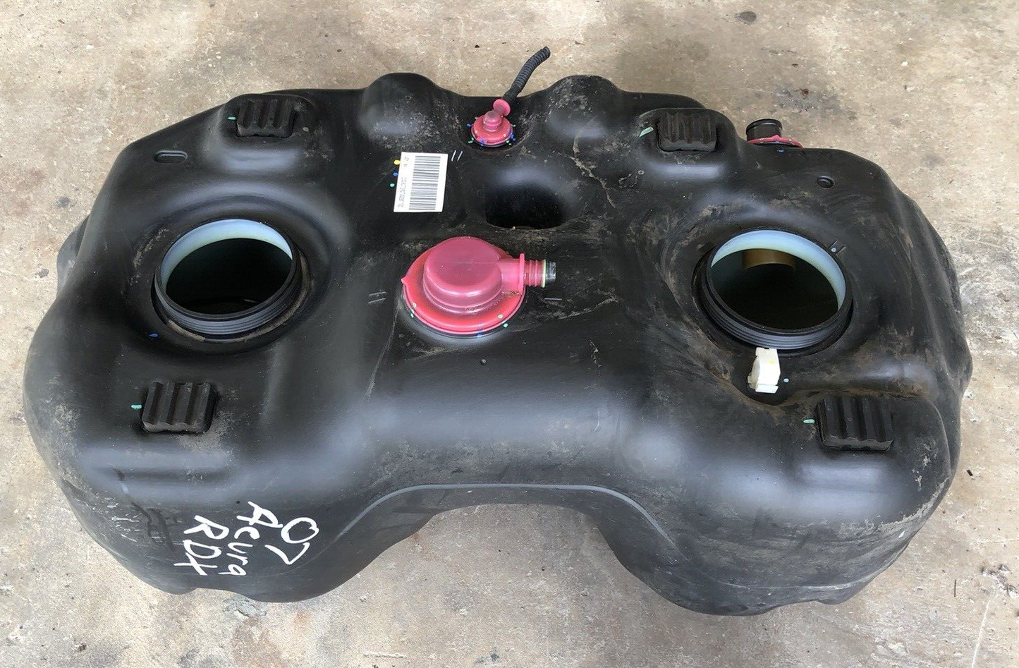

The gauges in these things aren't equally distributed across the tank. You might get 90 miles out of the first 1/4 of the tank. Then 75 out of the next quarter, then 60, then 50. The top of the tank is the widest and then when you get down to the bottom, you are dealing with the hump. So, if you drove the city miles first and then the highway, your results are to be expected. They could have done a much better job calibrating the gauge.
Picture borrowed from ebay
