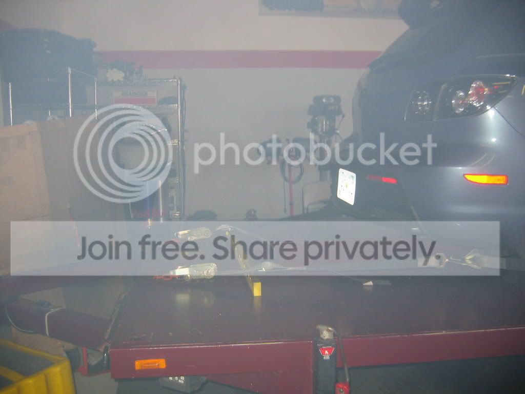

backpressure does not automatically mean bottlenecks ... going from 3" ID to a 2.5" is a bottleneck. Running cats/resonators/mufflers will also provide decent backpressure and is not the defintion of bottleneck.
bro, i came from an SRT-4 and a MazdaSpeed3. Many MS3's with a Full TBE have horrible smoke and oil blow by? You're not necessarily burning oil per say, however, it does indeed leak past the turbo seals.
Many in the industry stand by a 3" ID or 3" OD with a 2.85" ID. I'm not denying that, i am just simply stating that some backpressure is indeed needed and NOT ALWAYS a bad thing
the end ...
or it could just be that MAZDAS SUCK.

The smoke/burning oil is usually from the PCV system since a pressurized crankcase under boost usually drives some oil into the vacuum lines and the oil gets sucked back in under vacuum and burnt. Throw on a TBE which usually removes 1 or more of the cats and you get more smoke.
Most of the DISI engines oil burning seems to be a startup issue, not when under boost.
So a cat/resonator/muffler isn't a bottleneck? 6 and half dozen man.

boost spike issues with cars and a full TBE
2007 Mazdaspeed3, 2005 SRT4, 1997 Eclipse GSX, 1998 Fully Built FI Prelude.
All 4 FI Cars has plumes of smoke with a TBE installed ... Several i even ran open dp, and it smoke and smelled like ass...
i do agree, i have never seen an FI car have a "smoking engine" but i have seen HUNDREDS of FI cars with "smoking turbos"
EDIT: The World of Smokin Turbos ....

yo cash...u seem to be referring to smoking turbos....is that just a result of your mazda or your other turbo vehicles as well. Mazda's have documented problems with garbage turbos, especially the unit on the CX-7, which was a modified Mazdaspeed turbo. blown seals, busted out turbos, and bad smoke, especially on the cx-7 & speed6. so...i guess my question is, is your experience with the smoke just from the mazda or every other car uve referred to.
IMO, the mazda is junk. youtube has a bunch of vids of people filming the "smoke" coming out of their exhaust so they can prove to the dealer itsa problem and they can "replicate it". so claiming its a result of the specifc exhaust im not really sold on since the pic you have is of the mazda with those specific problems.
both the cx7 and ms3/6 all have the same turbo, therefore, carry the same issues as far as smoking turbos. however, its only happened on cars with a 3" TBE. you won't find a smoking turbo on a stock TBE.
