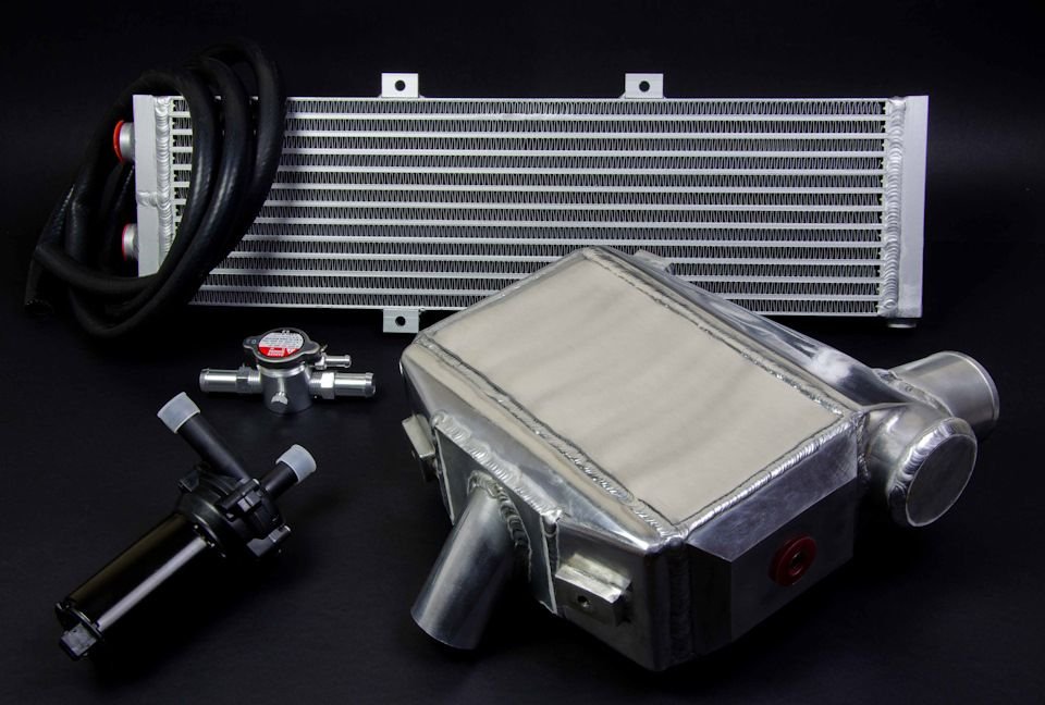

I will hook chiller to tank naturally) This ambient air for cooling will be outside not under the hood. Full kit of water-air intercooler includes actually water-air intercooler, water pump and outside water radiator.
For example picture of kit for RDX by guys from r2racing. This is not advertising, I was looking for what kind of intercooler is better to do and I think this is the best option for cooling and reducing lag.
When outside is -10 -30 degree, stock intercooler is great! but..

Yep...That system looks good....and they claim a 25hp increase too.
Post up some pictures of your installation

But this is stable 25hp if it the first run or second or third. On air-air intercooler decrease of hp on second run will be about 10-15hp, anyway ETS or stock. It's problem for all top mounted air-air intercooler.
