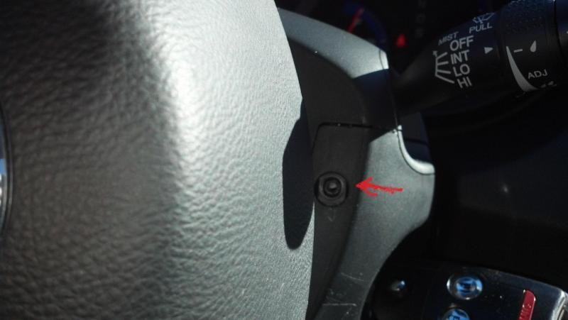

first off you will want to turn on the vehicle and turn the steering wheel to get 2 screws out here is a photo so you can get the idea of the location.. the other one is on the opposite side
once removed you will need to pop open the tabs to the top cover off the steering column by doing that take your small screw driver and pry it in the crack area above where the screws were, you may need to wiggle it but you should hear a pop once you got it. you will need to turn the steering to the other side after words just like you had to for the screws and do the same thing.. after that then you can turn off the vehicle
