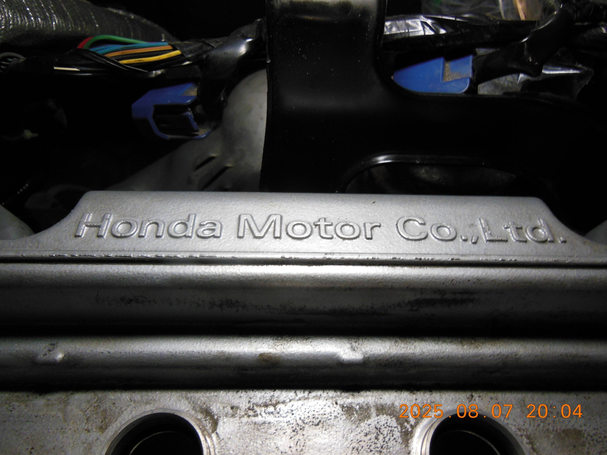

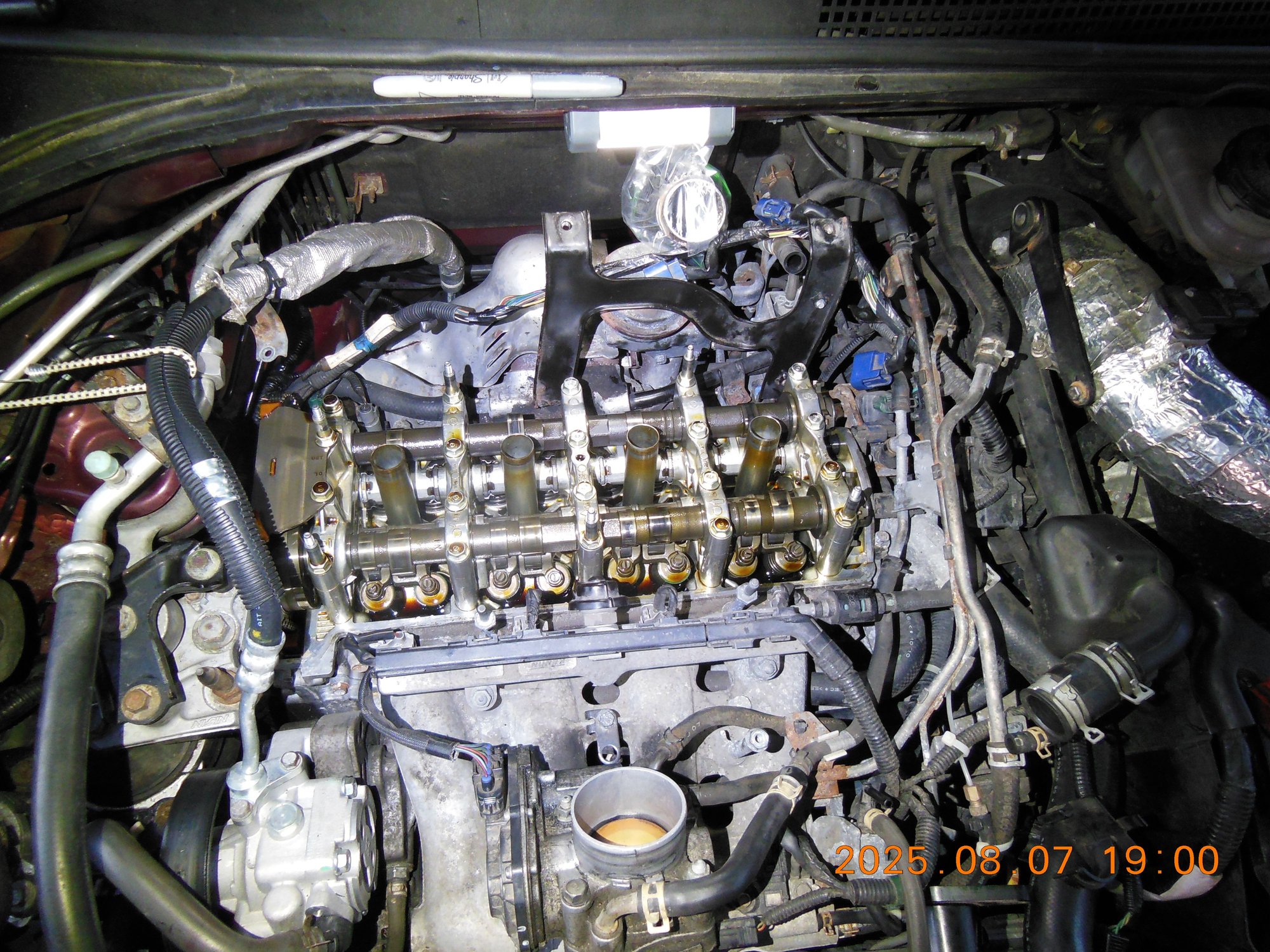

Just did mine the other day. Not too bad of a job. Half the work is getting the intercooler off and getting the coil pack wiring harness out of the way. All in all took me about 6 hours and I could probably do it faster next time.
At just over 203k miles (and with the last valve adjustment done by the dealer @ 110k), all my intake valves were within spec but all my exhaust valves were too tight. I could barely get the .008" feeler gage under the valve lashes on the exhaust side despite the spec being .011" to .013" so this was a needed service. I'm pretty sure the old valve cover gasket also had a small leak.
It definitely helps to have angled feeler gauges and one of those jam nut/screwdriver tools that lets you hold the screw in place while loosening and tightening the jam nuts. I also replaced all the spark plug well seals (a seal puller tool is needed here) and the rubber grommet/washer things that go under the nuts holding the valve cover down.
After re-assembly I got a P0238 code at first, but realized I hadn't tightened down the two 10mm bolts holding down the bypass valve. After tightening those the code went away. Phew.
