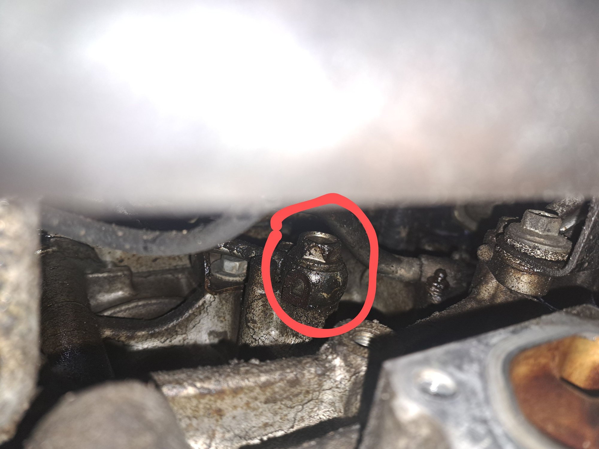

Any suggestions on discounting oil line banjo bolt from underneath? Under cat converter? If I can get broken loose, I can get my daughter with smaller hands and arms to probably take bolt off

After removing oil filter housing, the bottom banjo bolt is easily accessible

Yes I was. Axle wasn't touched. It comes down to having an assortment of wrenches and small narrow sockets. No lie the top left took forever to back out even with pivoting housing to the right after removal of engine mount. As you can see i have plenty of room now to get to banjo bolt *tomorrow

Got the banjo bolt out. Is there 1 more mounting bolt hiding near or under cat converter at top? One video mentioned it but none of the others did. I don't want to remove cat unless I absolutely have to
