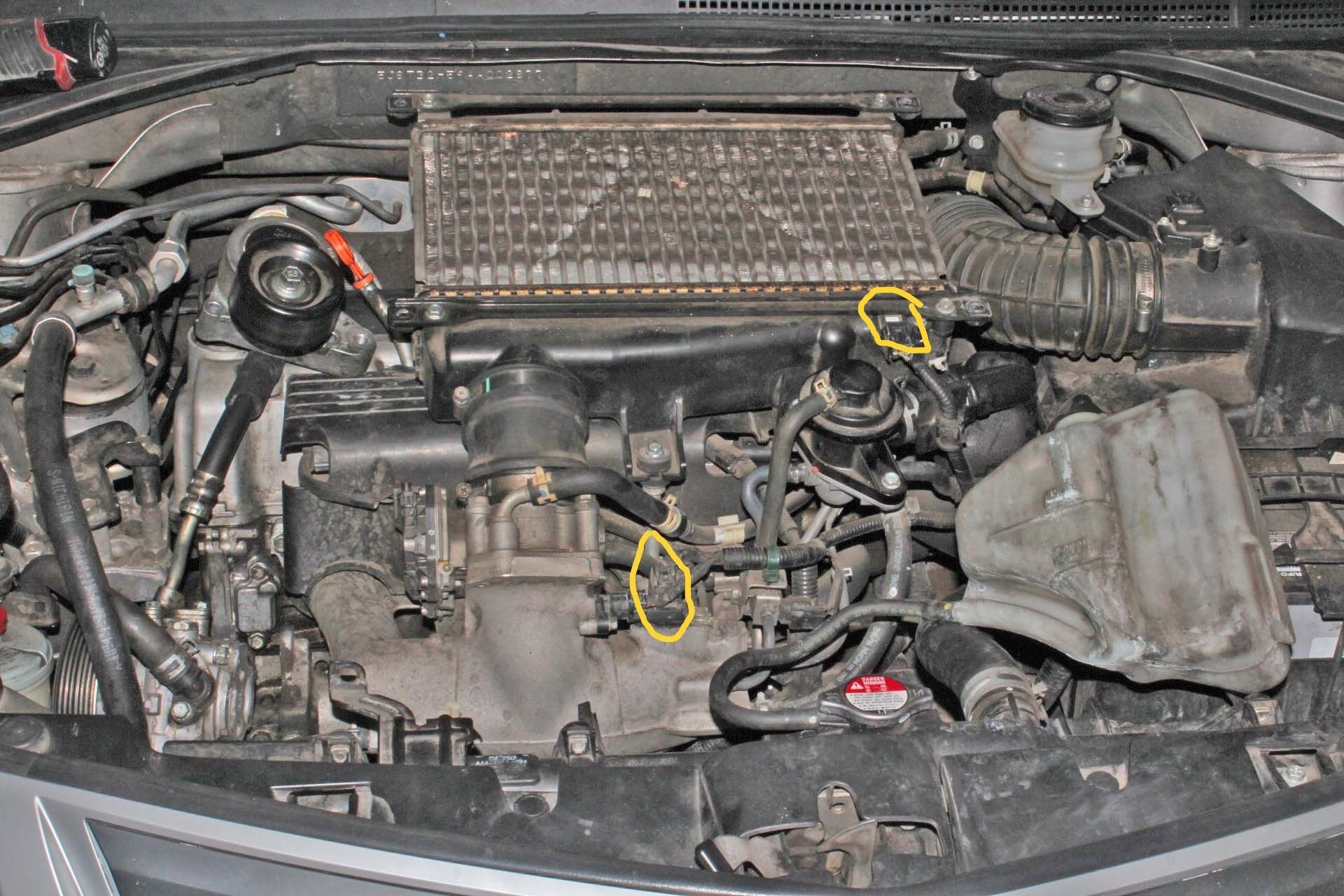

The boost sensor is the thing that clips onto the front right of the intercooler (looking at the front of the car with the engine bay open).
Is it possible you didn't plug it in all the way or possibly damaged it? Replacing the sensor will provide some insight.
The boost sensor has nothing to do with the ignition system, other than the fact that you have to remove it to remove the intercooler to get to the plugs & coils.

Check to see if wire harness connector it's plugged in correctly and if there may have been any damage to the wiring. The OEM sensor is now $485 and to be certain if the sensor is actually bad you can swap the one installed in the intercooler with the one installed in the intake manifold and see if the code changes or stays the same, if sensor is bad the problem will follow the bad sensor to the new location and produce a different code. These two MAP sensors are identical part numbers, 37830-RWC-A01.
