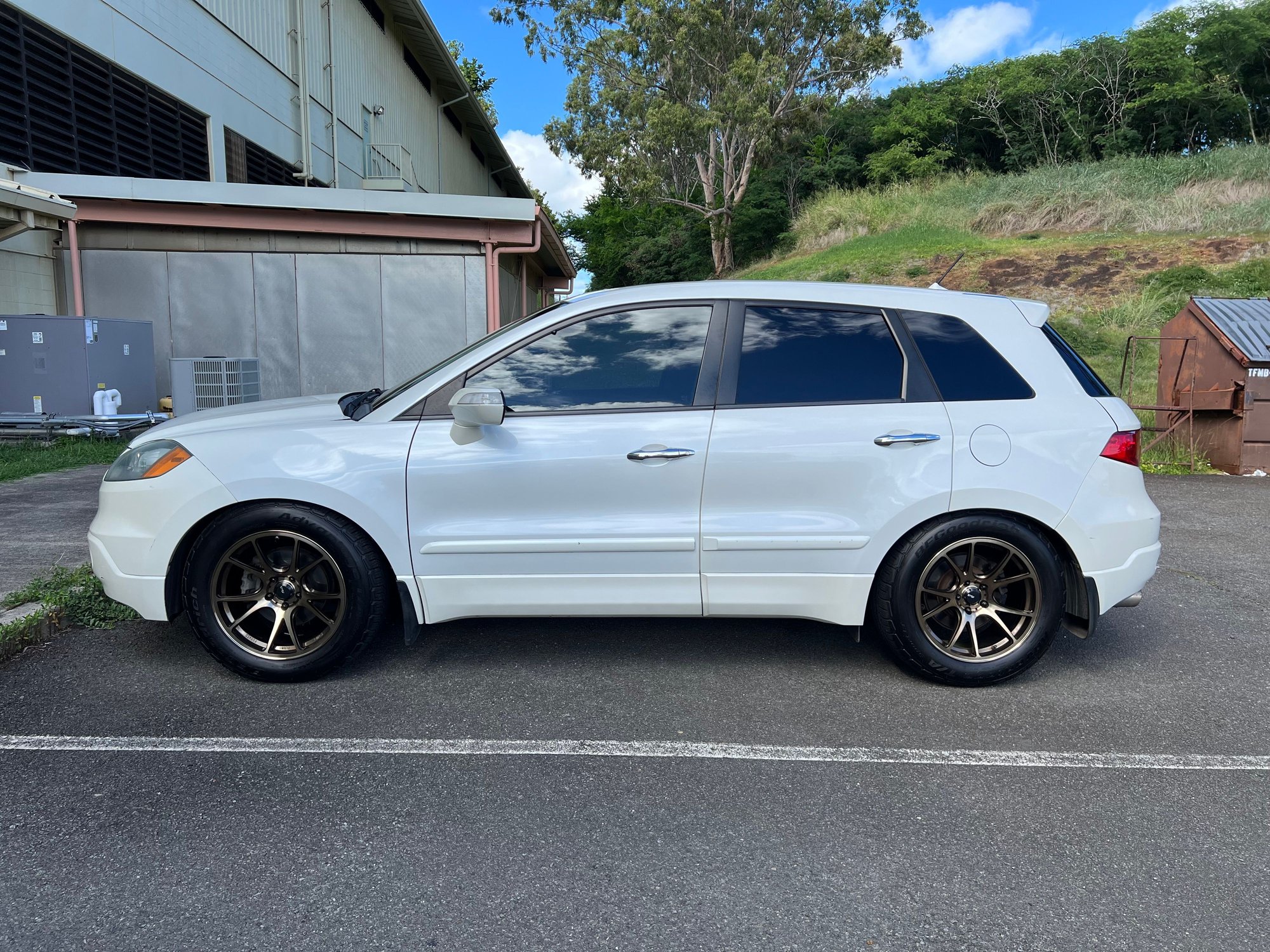

This is my RDX currently. I'm just finishing up the mods (have everything I listed in #3), and the car will be tuned come spring. I'll pretty much have maxed out the stock turbo capabilities.
