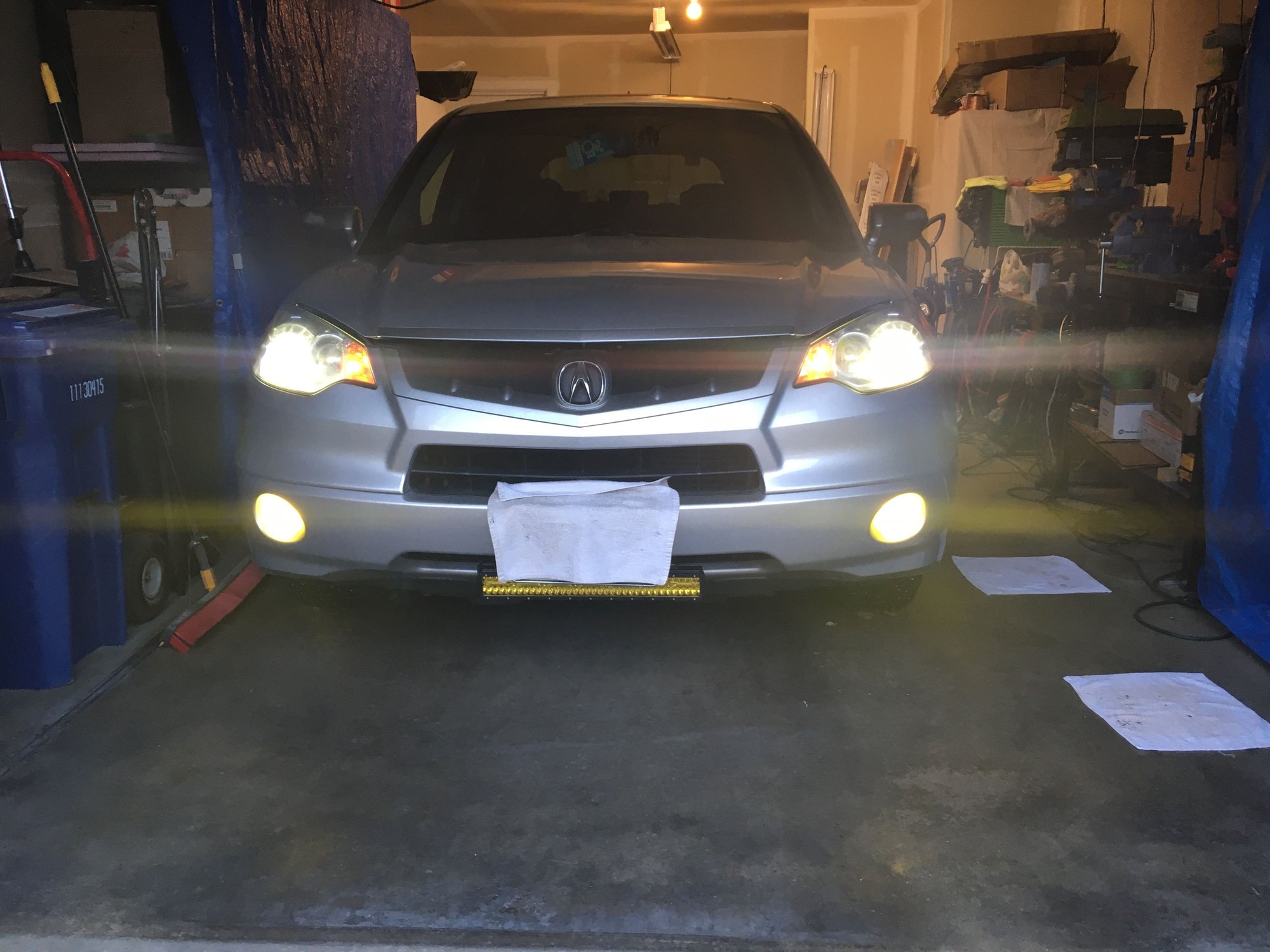

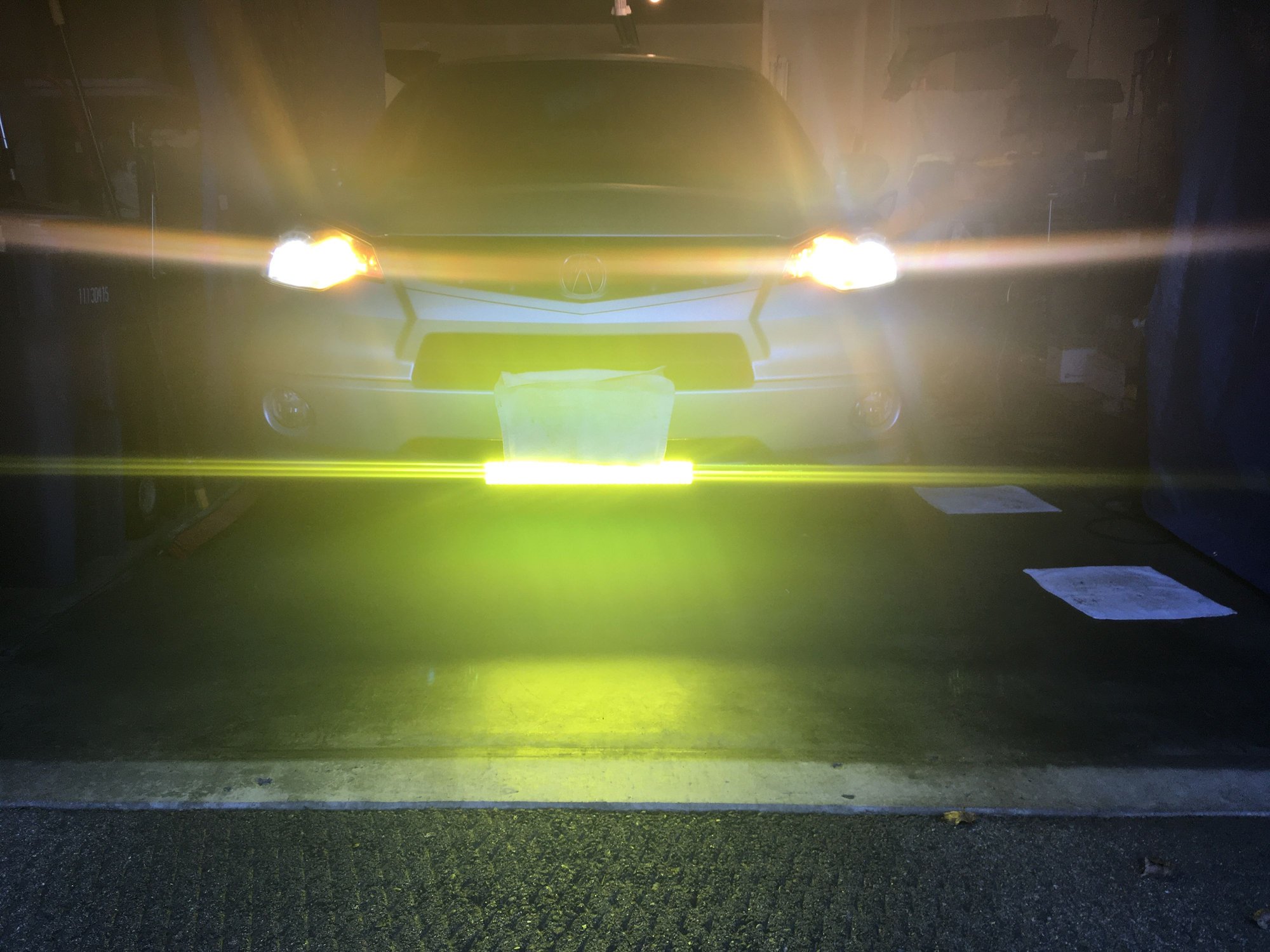

Old Dec 8, 2020 | 07:34 PM
Posts: 48,302
Likes: 9,172
Great, so anyone driving against you will be blinded
Can you provide output shots on dark roads, that would be a lot more valuable to determine usable light!

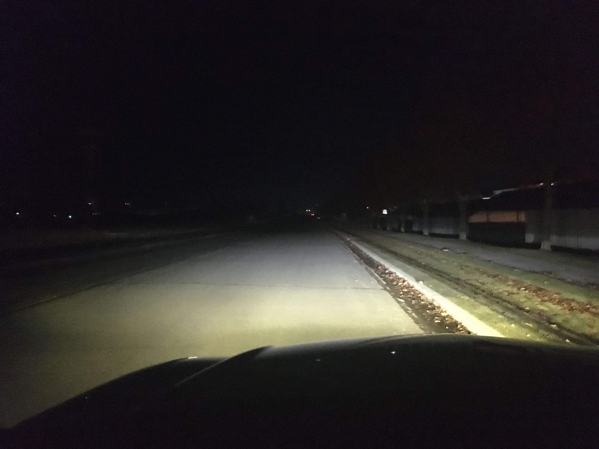

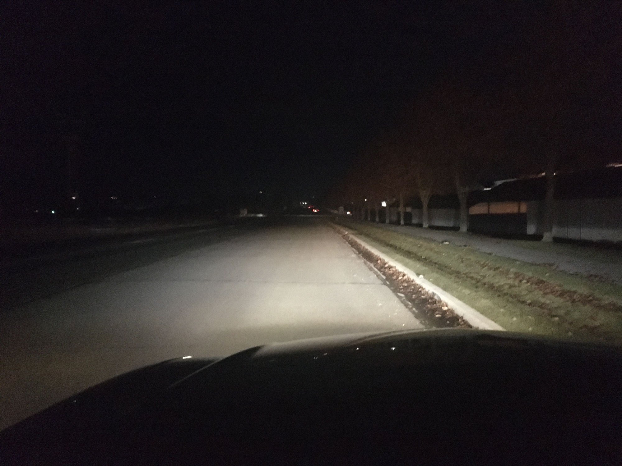

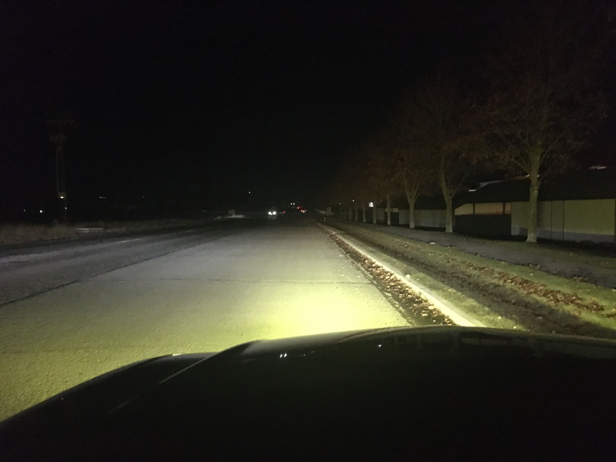

Old Dec 8, 2020 | 07:54 PM
DaIll1's Avatar
Joined: Nov 2016
Posts: 1,116
Likes: 213
I had to wait for the sun to go down, and yes, oncoming traffic will be blinded, but I don't use highs with oncoming.
Lows, Highs, Highs + bar.
When I did a lot of open road night driving I installed a pair of aircraft landing lights. Could see clear over 1/4 mile.
