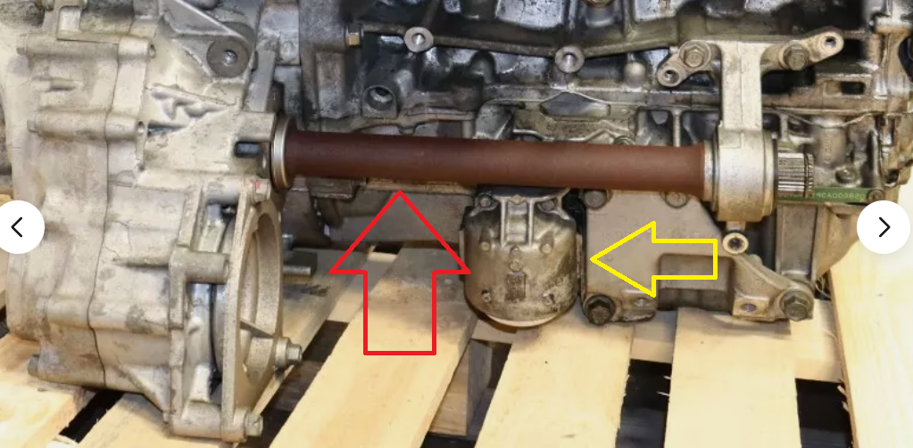

Originally Posted by DashingDaryl
I heard getting the three screws off the top out is very convoluted. You may possibly want to do more research
If the picture below is accurate, the yellow indicates the oil filter base with the half shaft blocking the top two screws?

Ouch - convoluted is an understatement there. I had been meaning to have a look underneath.
Ironically I had my buddy help me replace that intermediate axle (cracked heat shield mount) back in December. Would have been ideal to do it then - getting it out was a major pain. We had to unhook a couple of the motor mounts and lower the sub-frame a bit.

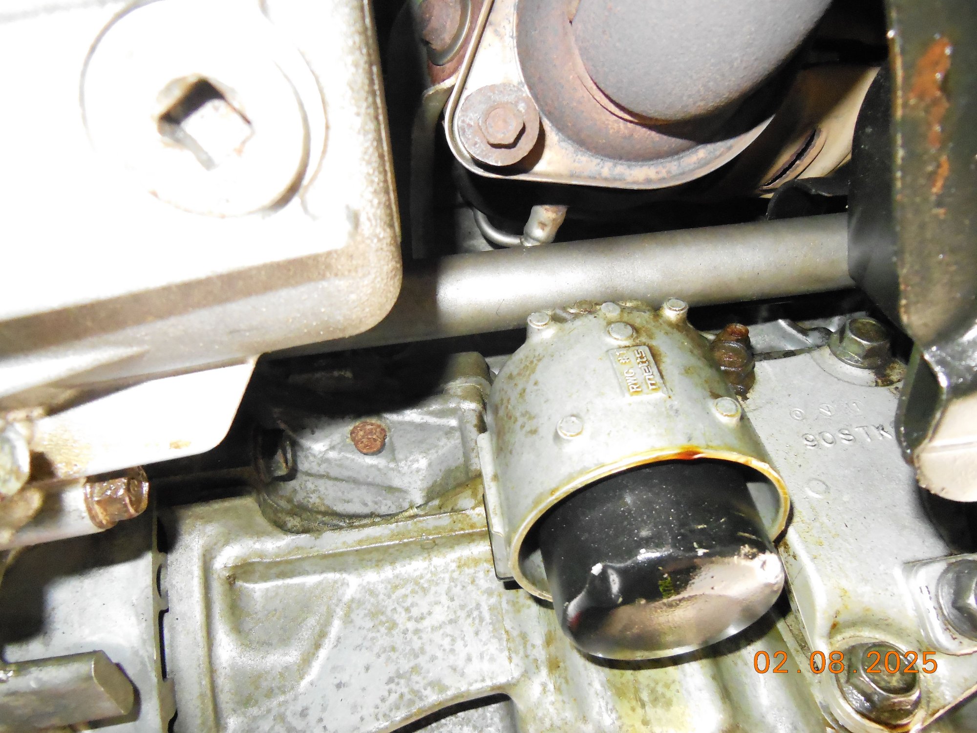

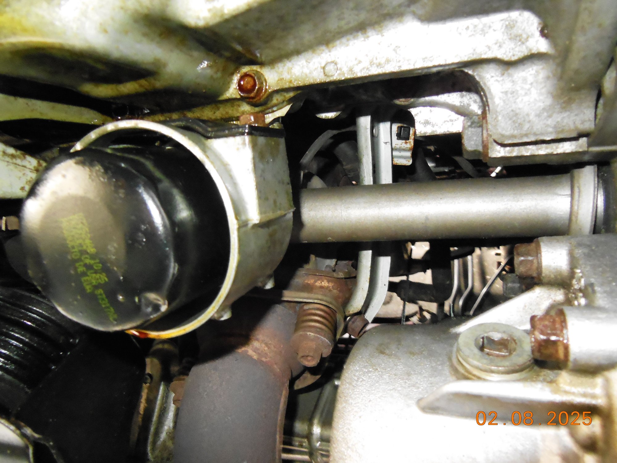

Definitely a doozy - but there's actually about an inch of clearance between the intermediate axle and those two bolts.
I also think it's more likely this is the source of the leak looking at these pix...

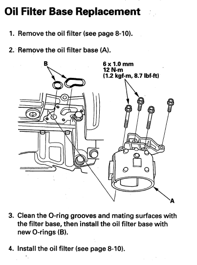

At 8.7 lbf-ft they should not be to bad; however, if rust is involved, all I can say is make sure you wear gloves, pray there is space to fit your digits & wrench inorder to gain the leverage you need for joy.

8.7 ft-lb to torque them back on, but I have a feeling it'll take more to get them out. Been fighting rusty bolts for the last couple months.
I stopped by my local dealership the other day and ordered new oil filter base O-rings and a VTC strainer. Btw, the guy at the parts counter said only those O-rings would need to be replaced - no sense replacing the entire filter base (which was $200+).
