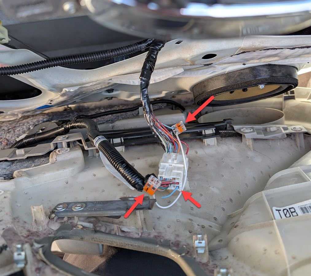

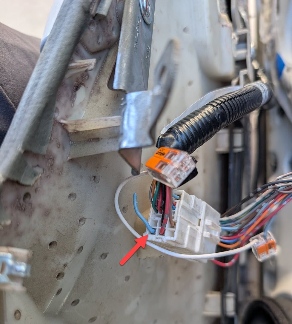

UPDATE:
So after inspecting the harness, and doing some wiggle and pull testing on the wiring harness to try and narrow down where the issue was, me and a friend were finally able to consistently narrow down the point of failure, and consistently reproduce it.
It ended up being on the harness connector between the door panel, and the door harness. There was a light blue wire we were able to pinpoint. The contacts on this particular pin were black, not burnt, but noticeably darker than any other pin on the connectors.
So we implemented a fix using some Wago wire lever nuts.
Clipped the wire on both sides of the clip, stripped back the shielding, put the ends in the wire nut. Then used additional longer wire to connect the two.
So far, the fix has been in place for a few hours, drove about 50 miles and the window is functioning perfectly.
