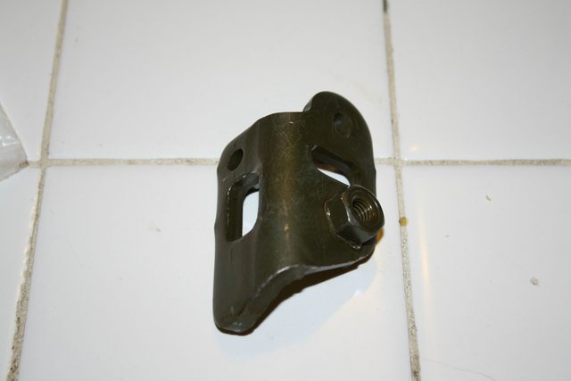

So I finally got the alternator bracket monday, I called a local Honda dealership and luckily they had one in stock (Only about $16 as opposed to $38.64 @ acuraoemparts.com) and that's where my luck ran out... the shorter belt that I put on exerted too much tension on the one bolt that was holding my alternator on and it snapped off in the block. I had to take it to a mechanic to get the remainder of the bolt out of my engine ($140). On the bright side, the new bracket I got from honda seems a little more heavy duty than the original. I could also see that this had happened before on the car and they just spot welded the bracket back together.
a pic of the old bustedbracket
here's the new one

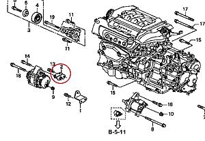

Also if you order it from www.oemacuraparts.com (thanks to timeizmoney22) the top bracket is the one I circled in red, part# 31113-P8A-A00.
