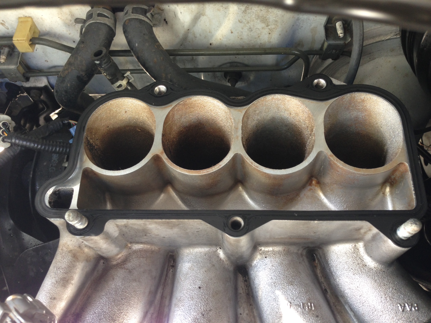

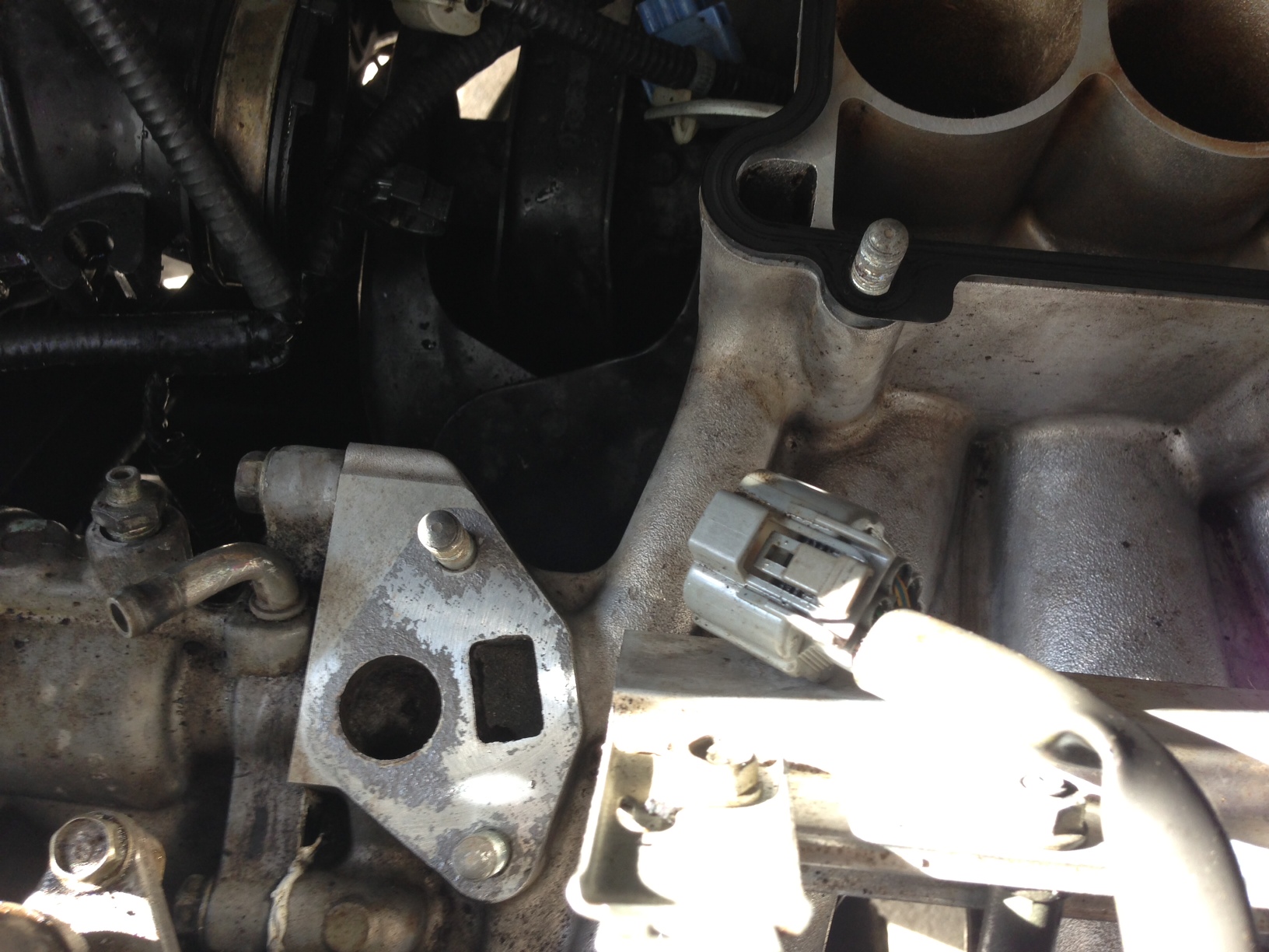

Here's my EGR passage after cleaning below, from the rectangular hole under the removed EGR valve it runs diagonally up to the corner of the lower intake manifold, you can see the corner of the metal gasket in the upper right hand corner of the photo. You can get a small screwdriver in to clean our carbon and crud but mostly have to reply on spray on the diagonal passage, used two cans, both Carb/Choke cleaner and brake parts cleaner, both pretty effective. Try to keep all the carbon particles and cleaner fluid from running down the intakes into the cylinders, you can mop it out.

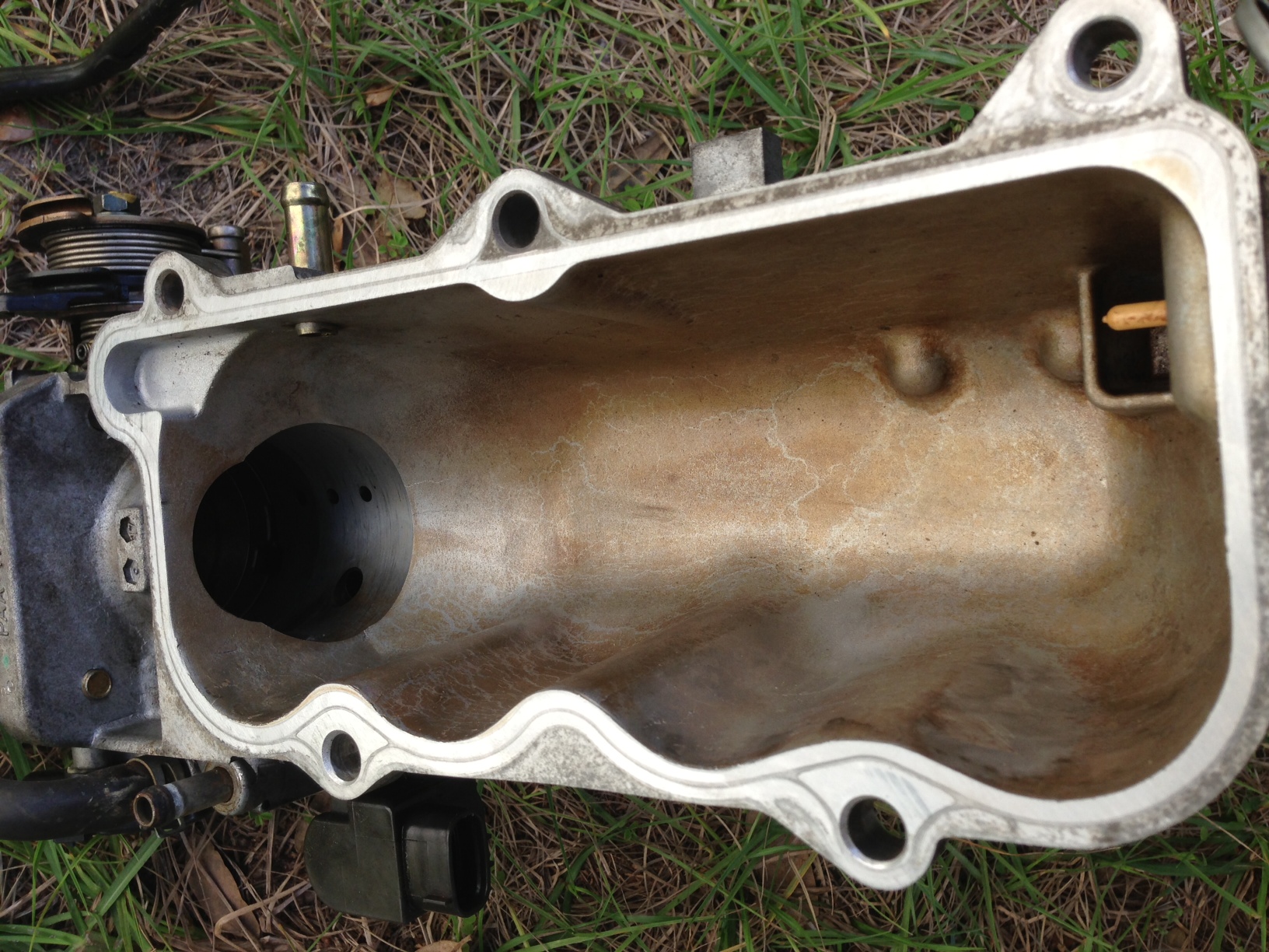

Here's my intake manifold lower and upper after cleaning ready to put back together, no real tricks there.
