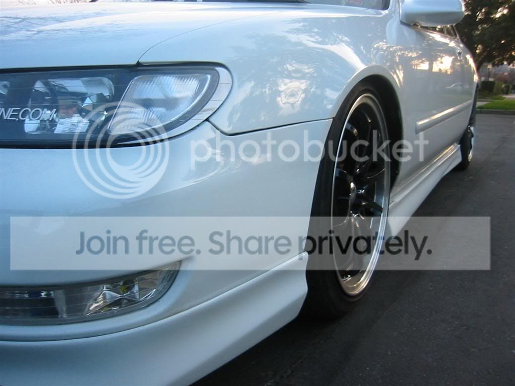

best pic I have right now, I have more at home, if you want
an older one before I dropped it some more
i forget if mine are +42 or +45, but they dont sit all too flush cause of my mad camber, yo

Hey klepto I read in one of your previous threads that if you knew more about rims when you bought yours, you would have gotten a different size. If you were to get new rims for your whip what size would they be? Thanks

just something with a more aggresive offset, and maybe try running 8" something along the lines of 18x8 +30ish or maybe even running a staggered setup

shoot, I love Klepto's setup even as-is
but yeah, our fenders are pretty accommodating in terms of width and offset...at least a lot more than probably most people think. I believe the fronts are good for up to an 8.5 with 40 series tires and mid 30 offset, while the rears are good for up to 9 with a 40 series and mid 30 offset with fender rolling, though I think probably even a 9.5 with a little more stretch and full fender roll
there's really no need to stick to a +4x offset with our cars...they can take a lot, lot more...
