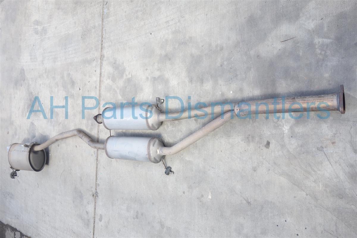

Just look at this nightmare....
That is all hard tubed (Welded) from the right exhaust all the way to the resonator and cat.. WHAT THE FREAKING HELL ACURA???? DAMN what will happen if somebody bent its exhaust tip that is also welded? Replace all that thing??

That is my thing too. I don't want constant sound, it gets incredibly obnoxious and sometimes I do want a smooth calm ride. Ideally I wish it would come alive at 3000 rpm and not 4000 but its ok. I also wish more noise would make it into the cabin and that it had a deeper growl.
Just so I am not confused, exhaust delete removes the 2 resonator looking things just before the exhaust tip correct? So like a catback exhaust? Does the 2G have multiple resonators, would removing just one be alright?
J-pipe is on my radar for sure.

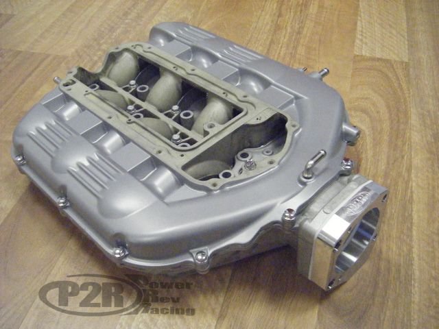

It all depends on the TB size and entire Manifold capacity.. You can use the biggest intake ever that if enough air cant cross the TB is useless... On our TL-S side the Intake and I mean the MEANEST and most Expensive CAI can only make around 4-7HP tops, That is because the TB is the biggest restriction not the Air Intake tube.
The MDX AFAIK has a bigger TB to accommodate the extra air flow, and by the looks of it the Intake is the least of the problems...
A Manifold plenum extenders like the P2R Plenums will be far more useful:
