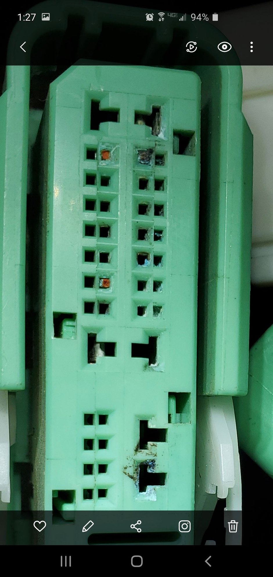

That's one of the first things I checked. Turns out I have some broken pins at the rear relay juntion box. I'm getting low voltage to the trunk area. If you want t
he full dealer service repair manual i can send you a link.

This is most likely due to a very common water leak with these MDX's. The roof/windshield moldings need to be removed and the roof body seams need to be resealed with Sean sealer or window urethane is what we use. Also the tailgate trim pieces on the door jamb need to be removed and the clip holders need to be sealed as well as the seams the run down from top to the tail lights. Hopefully this makes sense!
I'd also inspect both front dude box areas in the kick panels for signs of a water leak. Those fuse boxes ain't cheap. Especially the driver's side one because it's also the MICU.
