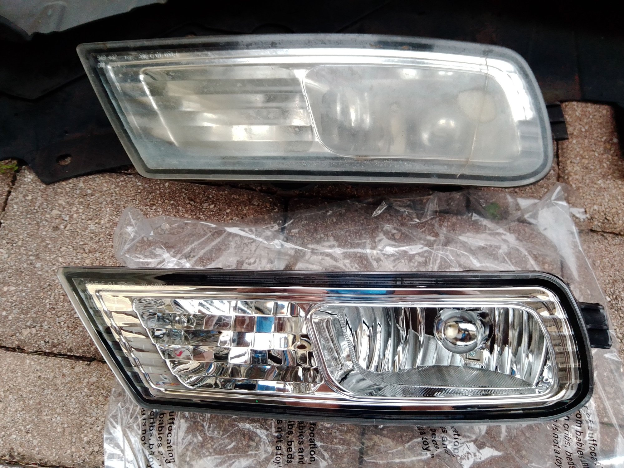

So, the MDX has has a cracked driver side fog light lens and the passenger side DRL burned out a few weeks ago. I didn't think anything of it and said I'll get around to replacing it soon.
Well, car didn't start today after a weekend of driving. I assume the blown bulb is draining the battery? Currently, reconditioning the battery in the garage. Figured I might as well replace the fog light housing, so has anyone tried out the TYC set from rockauto?

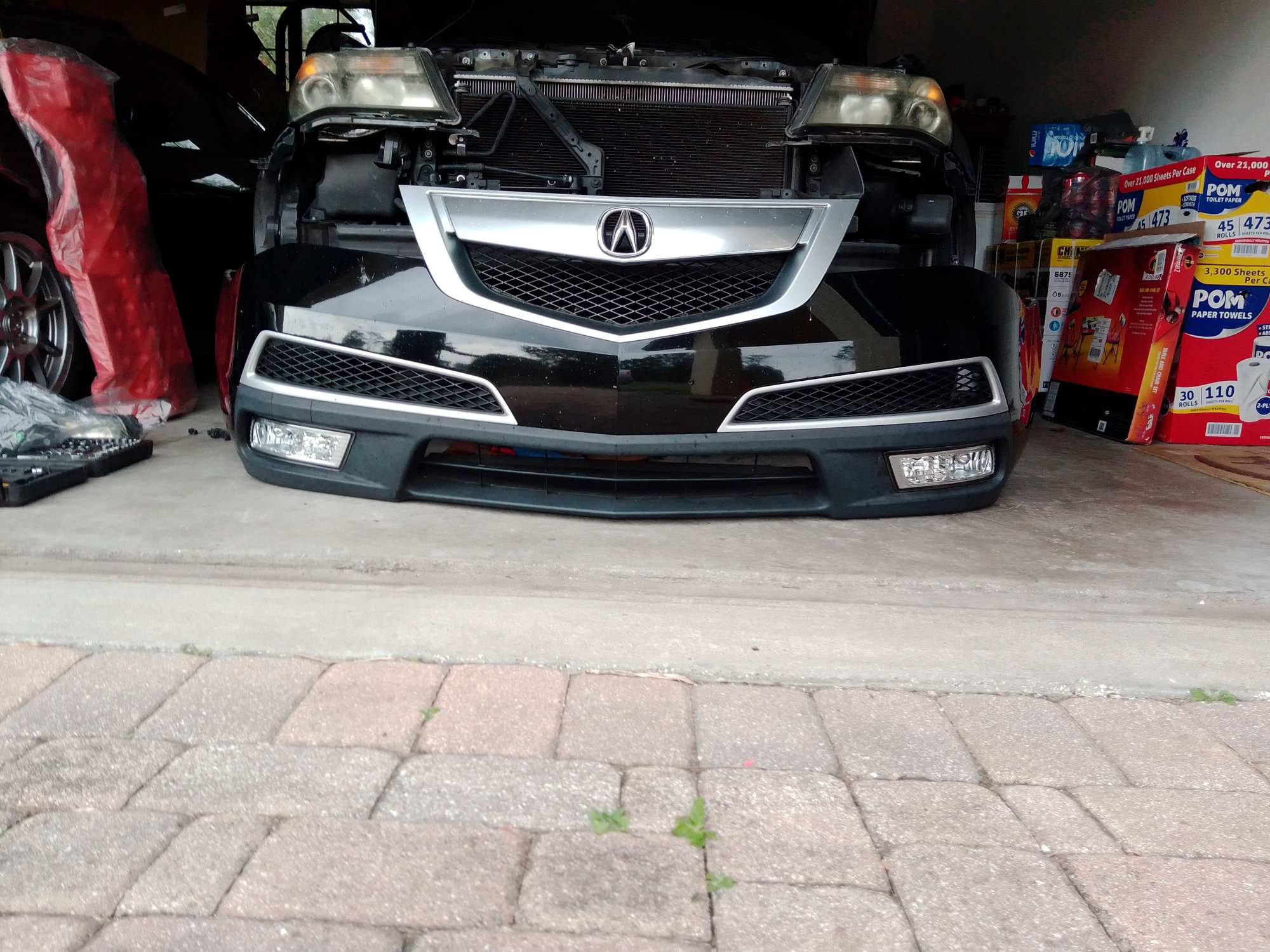

Installed! Overall, product was packaged well, looks solid and included the DRL and new fog light bulbs
Driver side
Passenger side
All done!
