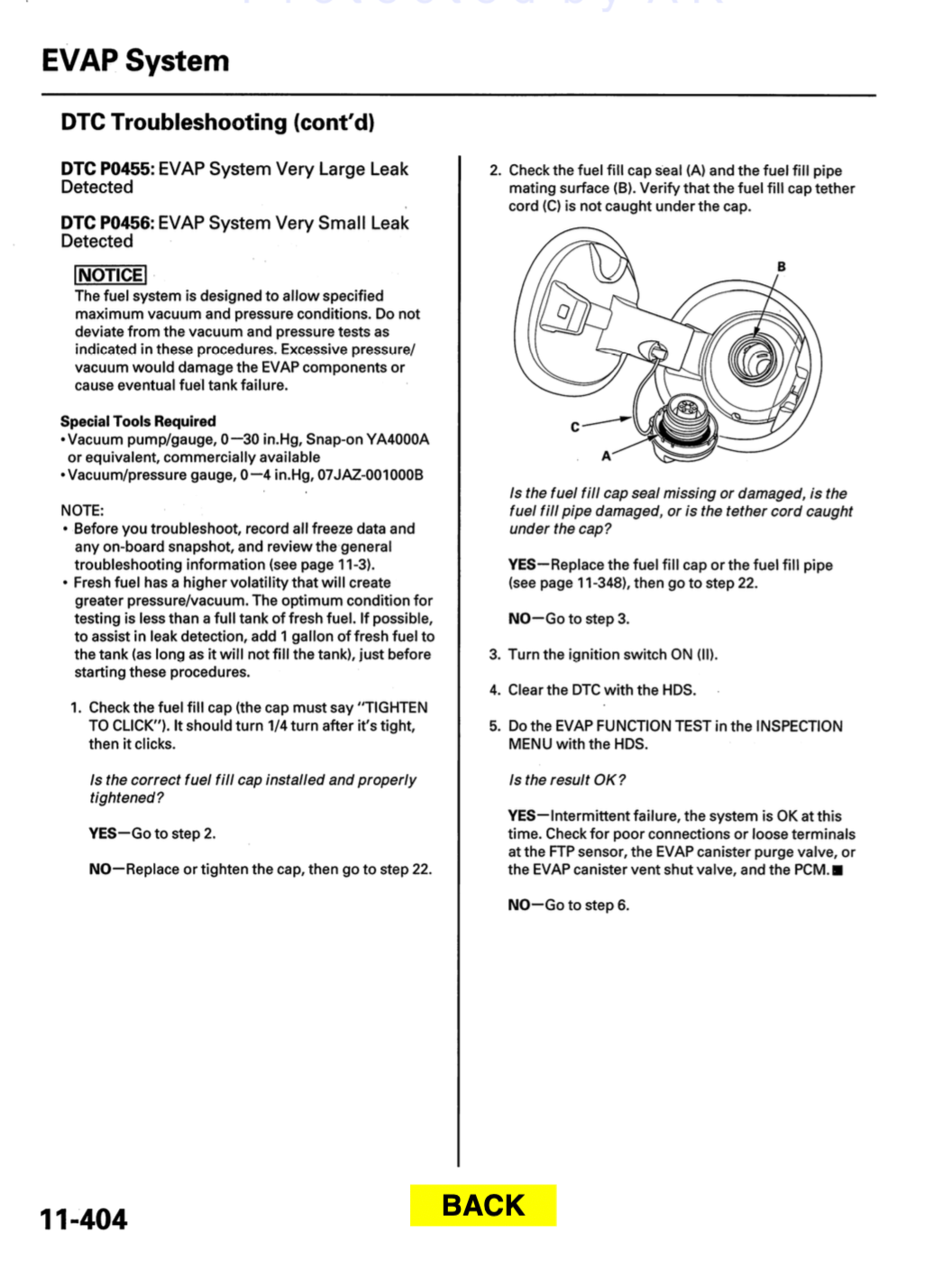

could be a few things:
1. Bad Fuel tank pressure sensor (FTP) or bad o-ring on the sensor
2. broken wire between the system and the ECU causing the system to not function properly.
3. Crack/leak in fuel tank
The service manual states to put a vacuum system on the gas tank and monitor the fuel tank pressure sensor and see how the values change. If it doesn't bad FTP. If it does but not according to how the pressure is there may be a leak/crack somewhere.

Old Aug 1, 2020 | 07:24 PM

Originally Posted by csmeance
Thanks for this brother.. im assuming the dealership did this cause i brought it in to take a look at this problem.. and i replaced that canister that also came with the sensor
