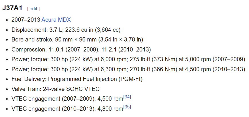

Have you verified that the correct engine has been installed and all relevant engine harness connections are intact?
It is odd that the local mechanic would release the vehicle as mechanically finished with such irregularities occuring.

To my knowledge it is. I gave the seller my VIN # and they stated the engine was compatible with my car.
