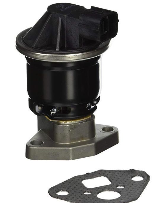

Originally Posted by Acura 101
Where is the knock sensor and the EGR...are they a hard to find or difficult to access?
I have an 04 MDX Navi/RES
Thanks
The EGR valve is pretty easy to get to! Take off the intake manifold and ignition coil covers, and it's right there on top(right side) of the engine. Looks like a round little house, lol!

Great thread and helped me so I wanted to follow up.
Similar symptoms on a 2003 Acura MDX that came on suddenly. left the airport running fine, got half way home check engine and VTM-4 came on. Exited the highway and rough idle.
Didn't think it was valve clearance in my case because of the sudden onset. I had just filled up a fresh tank on the way to the airport, maybe bad gas. Filled with good brand premium and no change at all.
Thought maybe a coil bad or a plug bad (255,000km on the odometer... no coils ever changed and plugs have at least 100,000km on them)
Initially I got out the code reader and just cleared to codes to see what came back and along with misfires all cylinder codes I got a P0404 EGR code.
The 2003 MDX EGR is dead simple to remove. Four 10mm bolts hold the plastic cover on. Two half turn plastic screws hold the plastic cover around the oil fill area. The a 12mm takes the two nuts off the EGR studs and the electrical connector and its out.
Mine was a dead giveaway. Seized open.
The valve has a torx socket in it, I used a torx screwdriver to twist the valve back and forth (I didn't rotate in case there is an adjustment thread) and it freed up. I cleaned with carb cleaner and a brush as well. If it was a hard part to replace I would have ordered it and waited but its easy so I reinstalled the old one I freed up and ran fine. If an EGR was expensive I would have used the working old one but they are under $100 so I ordered one on Amazon and will pop it in tomorrow when it arrives.
Easy fix. Phew.
