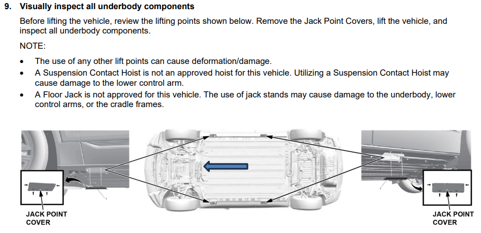

See chapter 9 in https://www.urvi.net/forumfiles/SB/B24-024.PDF

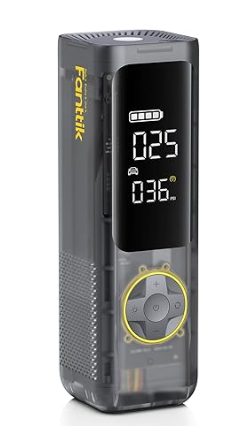

As indicated by mulunu's data above:
At a minimum, in an emergency 'tire' situation, if I owned one of these EV's, I'd have a couple cans of 'tire goo' on hand.
As well as a portable tire inflator (they work great!) like the one below:
If the tire emergency is presenting as a sidewall perforation, then you are pretty much stuck.
However, if the tread perforation is minor (small screw / nail et al) you may get lucky with the above items.
1) I would visually try and 'find' where the leak is and what is causing it on the tire, if possible.
2) Determine if the foreign object is able to be removed or should it be left undisturbed?
3) Once the leak location is determined, I'd orient the wheel (by moving the car forward/rearward slightly) so that it is at the bottom near or at road level.
This would let gravity help facilitate the 'tire goo' downward to cover/find the leak area quickly?
4) Following the 'tire goo' can directions, apply the appropriate amount giving it time to reach said leak area.
5) Use the tire inflator to, hopefully, find joy allowing one to quickly get back on the roadd to locate the nearest tire repair facility.

A floor jack is not approved for this vehicle.
How is this not illegal under right-to-repair laws?

The print screen below is from the ZDX emergency response guide (compiled by Acura) for first & second responders indicating blue highlighted factory lift points with clear instructions to stay well away from the orange battery area.
mulunu's Acura Service bulletin 20-024 data states a floor jack is not approved for this vehicle & the use of jack stands may cause damage to the area / parts listed.
Then a little further down, within the service bulletin, it indicates depending on 'lift type' one may or may not need to remove the jacking point covers.
As a result, since inter-web images of these ZDX EV lift points are non-existent, it would be interesting to visually observe how 'hearty', if you will, the construction of said lifting points are, as well as just how large of a surface area exists, if any, for potential use of a floor jack or jack stand???
Anyone up for the challenge of an actual picture(s) of these lift point areas on their ZDX EV??

Looks as if a full lift if the only approved way to get this vehicle off the ground. No floor jacks. In other words, the entire car comes up at the same time. I can understand why this would be. I would not be surprised if this is common of most EVs.

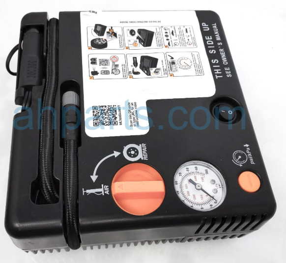

I notice in the owners manual it mentions there is no spare tire, or tire changing equipment. It does reference an inflator and tire sealant kit. MY CAR HAS NONE OF THIS. Is this something only Type-S gets? Should my car have an inflator and a sealant kit?
Old Dec 11, 2025 | 06:23 PM
Posts: 6,945
Likes: 2,221
You can purchase the complete OEM kit (less dealer markup) at the red online price with included sealant before shipping & taxes below.
Search the part number for the best price, ebay has salvage units available for lower $$.
Then, when you use the sealant / inflator function above, you'll have to purchase the one-time use OEM sealant cartridge replacement (below??) for the next emergency at $88.60 each.

Purchase something like the below portable inflator for $60 & two Slime Flat Tire Repair canisters for $14 each on Amazon & hope you'll never have to use them?

^Do traditional tire patch kits not work with self-sealing tires?
Edit: I have that fanttik inflator, and other than being a bit on the slow side it works well.
