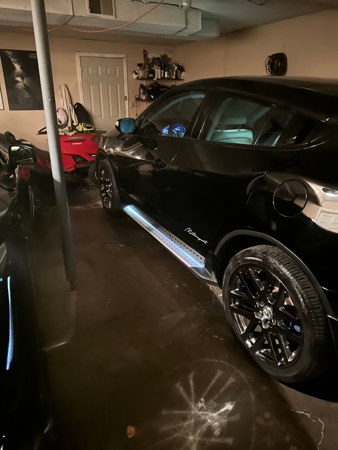

Has anyone’s light on running board ever go out partly ? I hardly ever leave my door open and part of mine went out and a shop fuxsd it but it was a while back but I just remember he has to get creative. Just curious how anyone else fixed theirs.

I think you're referring to one of the LEDs being out on either end, which illuminates the acrylic piece running the length of the running board, correct? If so, I have replaced one of those 6mm LEDs. (LED Bolt Flush Mount Lights | IP68 + 12 Volt | Oznium LEDs)

Thanks !! If it goes out again I will try replacing it myself.
