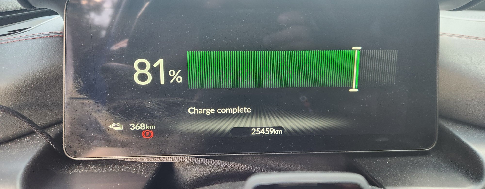

I recently had an software update and my car lost range.
I am
not sure how to describe but my 80% used to be 389 and 391 range, now it is fluctuating between 365 to 381. Any thoughts?

i actually very cautious on pedal pressure. Right after software uodate it is just keep changing. I haven't seen any physical changes yet (or haven't recognized) but it suppose to improve battery management system. Did you have the same update?

You didn't lose range. It's the BMS resetting after an update. The range will stabilize after a few drive cycles.
Also - batteries don't store miles. They store energy. There are MANY variables at play that will skew how far you can drive on that energy, some as simple as how fast you drive, others as complicated as head/cross winds, elevation changes, ambient temp, and battery temp.

hey team, all, it looks like I don't rrecieve any emails as if someone replied or not. My range has been fluctuating between 360 to 379 while when I got for the first time I was dead on between 390 to 391 (km in 80%).
I understand driving habits and etc, however based on my measurements I can easily say that each 70km trip, I record of less of a 10km range (especially compared to cold and windy weather's, while I do not have that anymore)
one think to notice, when I do city driving it most doesn't spend any range (we have good weather now) in addition, when I come back to car, the ranges goes up around 5km or so... I checked the regen and I do not regen 5km (i live in a very small town).
i checked some forums in Lyriq, they had similar updates but some people talks about range increase. I had an range decreased because I have a Type-S model ?
one other change that i can physically feel, when I want to give an extra gas, now it makes a kick and makes the acceleration like turbo engagement or downshift drive. You can actually feel it if you pay attention your foot when you are moving the gas pedal. Do you think they put like eco stage vs non eco stage ?

I woke up with 400km with 82%
2 days ago I had a long almost nonstop drive around 280km at 401, do you think software keep changing or us ut something to the with weather ?

Probably from the long drive. Even on colder days (>5C), the car can show good efficiency after a long drive.

the weather has something to do with this as we are average 15 to 25 degrees and now my 82% is 418km
