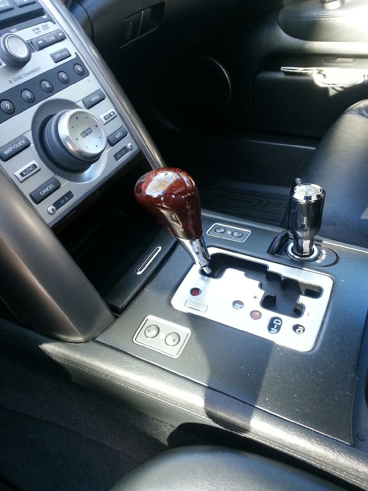

if my only option is to tow the car to the dealership , how do you put in on a flatbed when car is in park and will not response to anything?
There is a cover to the left of the shifter that pops off and you can place the key inside that overrides the break lever to out the car into neutral
cover next to P
cover next to P
Thank You this helped.
