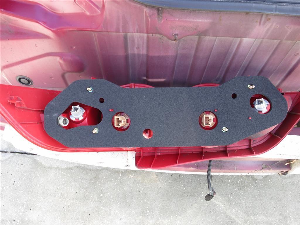

I was able to get the taillight gaskets replaced today. I removed the rear bumper and then the taillights and the gaskets looked to be original and were in sorry shape. The original gaskets had adhesive in four places on each taillight that had to be removed. I cleaned all the grime off of the mounting area before reinstalling the taillights. The Detroit Muscle Technologies gaskets are a perfect fit and appear to be thicker and better quality compared to OEM. This is based on having replaced them with OEM on my old RSX only to have them leak again a few years later. I attached a few photos below.
Next on my agenda is the valve lash adjustment.
These are the gaskets to get. $20 shipped on Ebay: DMT HONDA IMPROVED Material 02 04 Acura RSX Taillight Gasket Set
New gasket fits the taillight perfectly.
I got all the grime cleaned off.

that's the way...
I guess you could technically use clear rtv behind there to make a watertight seal...but those gaskets are damn perfect for cheap.

that's the way...
I used clear RTV with the original gaskets on my first RSX the first time it leaked and again with the new OEM gaskets. The sealant was a pain to clean off when replacing the gaskets. I didn't use any sealant this time. We'll see how it holds up.
