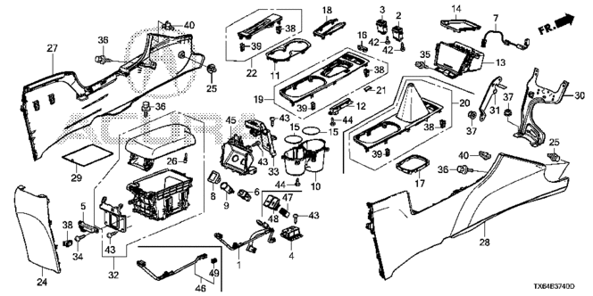

I don't know how I didn't notice this until recently, but my 2013 ILX has this cut out. Does anyone know if a cover is supposed to go here? I hate when things aren't buttoned up properly and are missing pieces. See photos. Please excuse the dirt and grit. I am getting it detailed tomorrow.

There is supposed to be a small plastic cap that covers that. Basically that is the shitter interlock over-ride. You know how you have to press the brake pedal while the car is in accessory more or on to be able to move the shifter out of park? Well if the car dies, you can't do that and this interlock over-ride allows you to insert a small flat head screwdriver to open the lock when the car is turned off so you can then move the shifter.

I can't seem to find the SKU for this item. Would you happen to know where I could buy one? Or is it even worth buying?

It's #21 in the picture. A little expensive for a little piece of metal.
77297-TX6-A01ZA Lid, Shift Lock *NH861L* (Neutral Shine Gun Metallic) $21.13 $14.79
LINK : https://www.oemacuraparts.com/auto-p...t/console-scat

Wow. I mean, I paid $6 for a hood prop rod clip. What's another $15! lol Thank you for the diagram.
