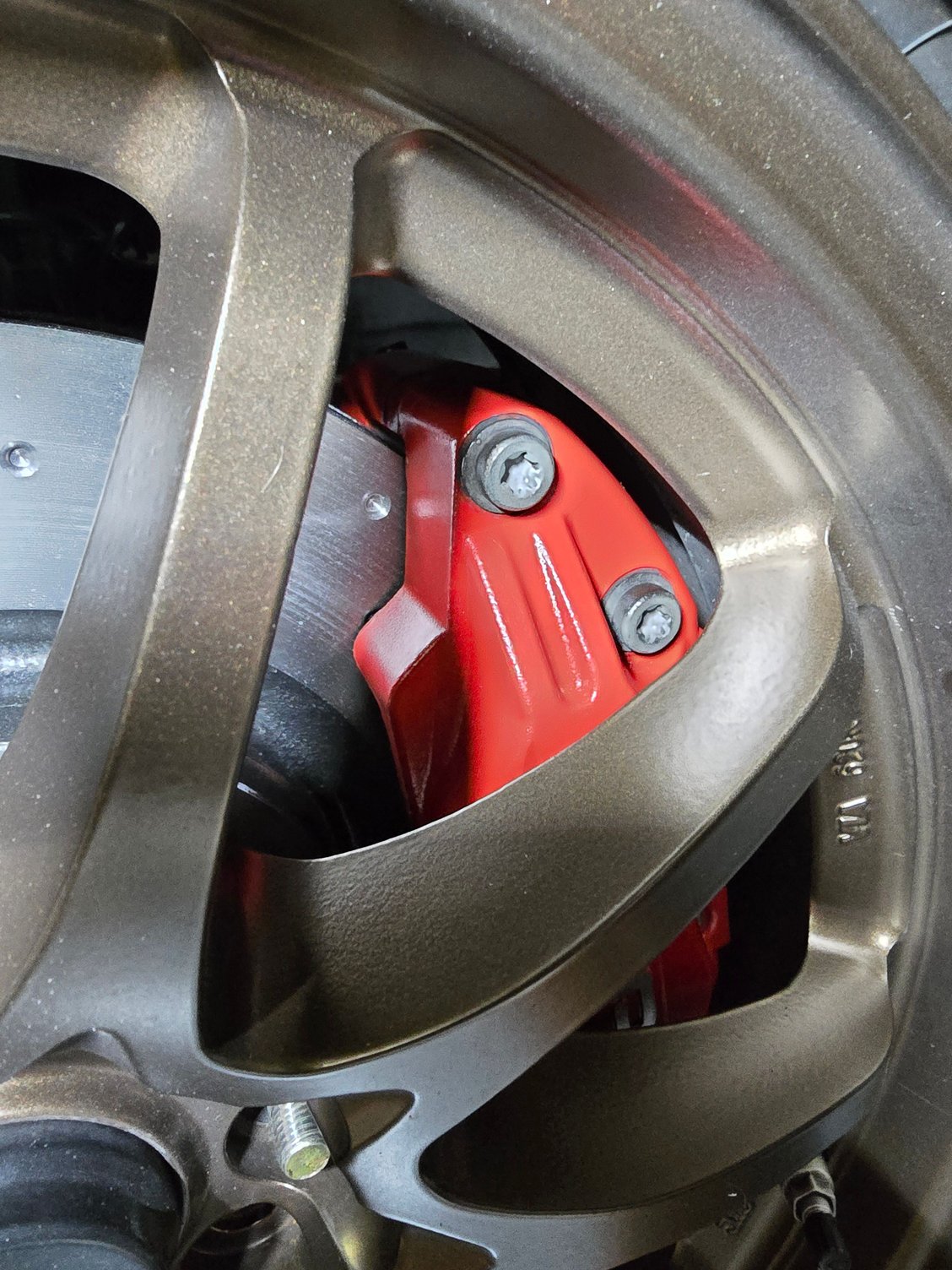

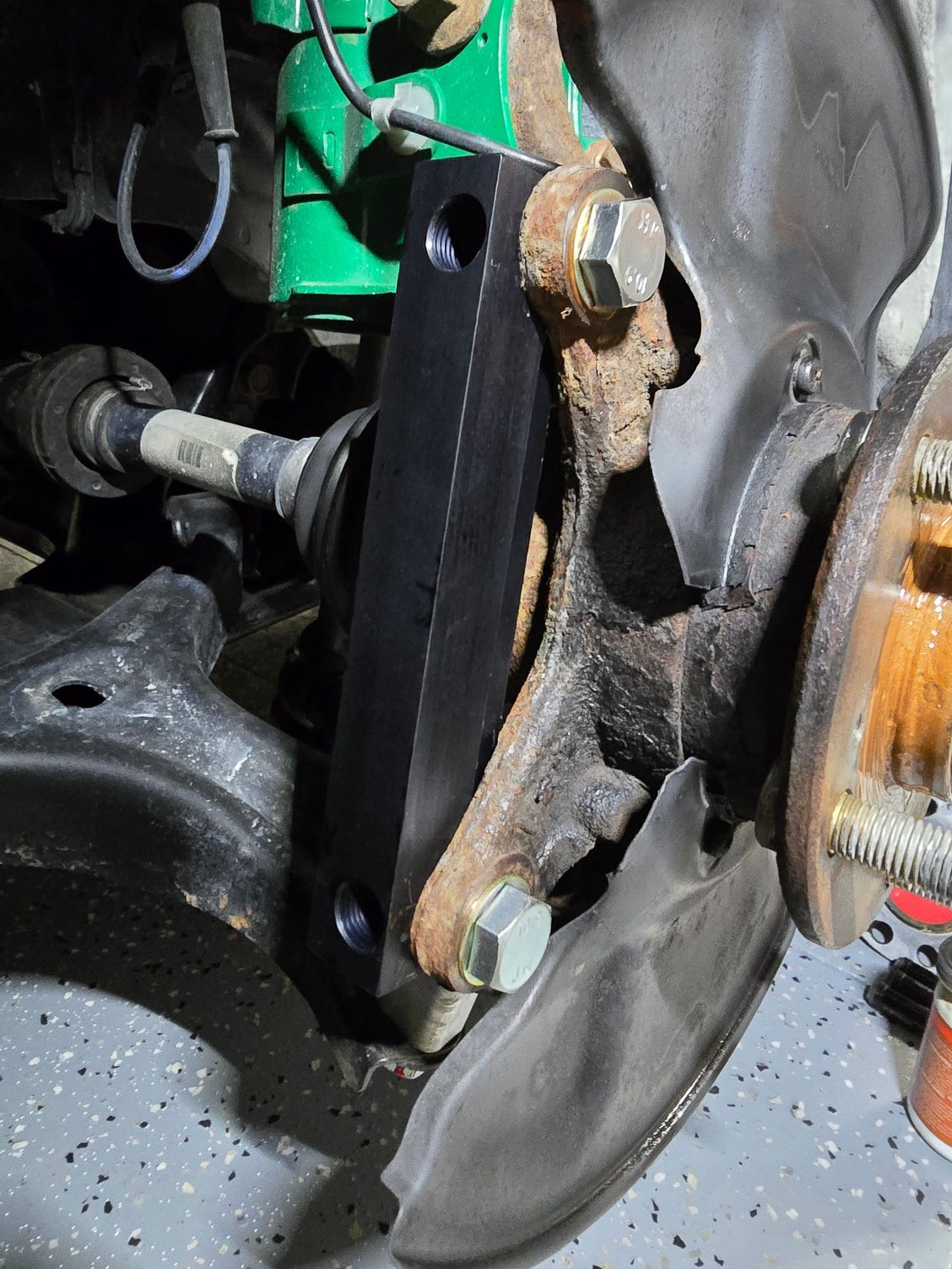

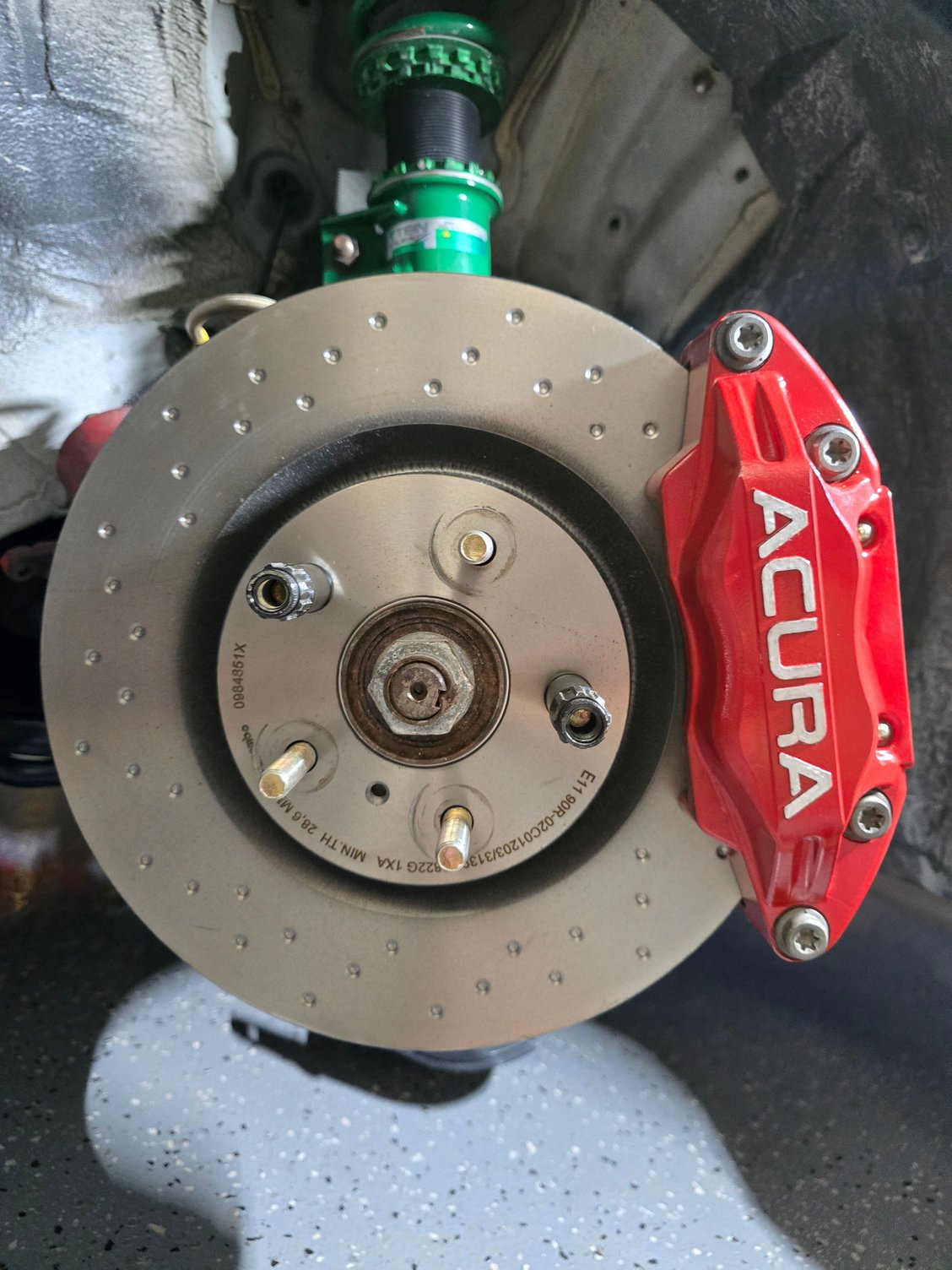

OEM big brake set up
350z with track package rotors, Acura RL brake pads and calipers with the fast brake adapter kit
1" bigger in diameter
Adapter plate
Good clearance.
