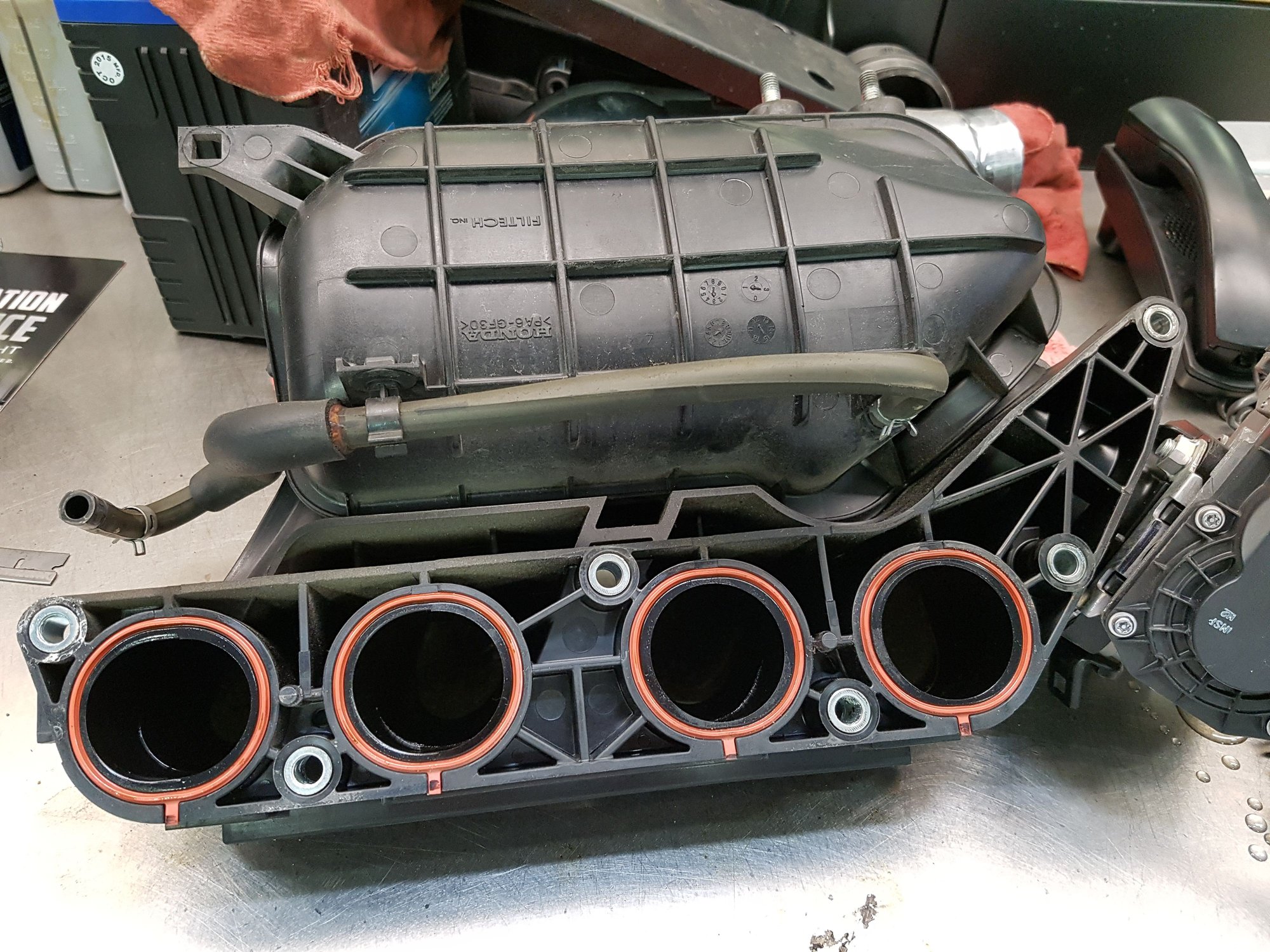

I have completed a couple performance mods on my 2013 2.4L ILX Dynamic (Manual), inclusive of which is an Injen Cold Air Intake (CAI). WhooHoo VROOM - With this mod I got an additional 25 more ponies....
Hahaha, yeah right... Maybe 3-5 HP if I'm lucky (and not necessarily over peak)!!!
But I did get a nice sound hitting the Vtec range out of the intake by removing the resonator, and that is always a nice plus!
I did however encounter some problems, lets call it a water hazard that definitely dampened my game.... I was on my way to work around 530am and encountered city water main that had burst and flooded the roadway with over 1.5 feet covering the road. I only noticed it last minute and slowed down and tried to roll through (as not to hit the throttle and suck up too much water), but the damage was done - I didn't throw a rod but must have bent a couple as the compression rates were way down.
So yeah.... I guess "I am that guy" who hydro-locked their engine!
Yup, that is road water in the cheap Acura Intake manifold. Not your typical clean and clear variety this stuff was brownish - Yuk!
Took the ILX into the nearest Acura dealership who did the work. It took approximately 4 weeks for them and the insurance company to sort it out, find a used 2.4L SI engine, and slam the thing in. The whole repairs cost $6,701.46 CAD to fix - Dammmnnnn!!!
This 2.4L baby is apparently from a Honda Civic SI, written off with only 10,000 km (or so they told me). Too bad they didn't include the transmission with the LSD.
So was it all worth it.... You choose! In this case I had a police file number which got passed on to the insurance company who covered the claim. In reality I did mod the car, however I was not the one who flooded the roadway (perhaps the insurance company went after the city to foot the bill). Cost me $200 and I ended up driving a 2017 RDX Premium to use (thanks to the dealership) along with an engine with 40,000 less km on the odometer....
And that's about all folks....

Hmmm, an air bypass might be worth picking up and is an easy install. I live in a city with lots of rain however in this case the road was totally flooded with easily well over a foot and a half of water, I have had CIA kits in the previous two vehicles as well and never had any issues. I suppose it only takes once, and who knows if lighting strikes again?!?

Ever since I had a CAI, when I noticed what appeared like potentially deep water ahead, I would actually turn the engine off, pass through, coast for 5 seconds, then start the car up again and keep going. I've only had to do it like 3-4 times in many many years, but still... always gave me peace of mind.
That is a way better, and a safer route. You don't want to have to go through what I did especially if you have to foot the bill.
With this incident I had driven it many times with lots of rain and some pooling of water in that same intersection but only a couple inches. Partially why I didn't notice the water level until it was too late, I would have drove around it and coasted through in the shallower area. I have also had CAI in my previous two vehicles with approximately 8-9 years of driving with it and never came across anything as deep as this. Generally the physics of what has to occur is that the air filter has to be essentially entirely submersed (or almost) as air flows easier than water which is heavier and more dense - path of least resistance.
I have just rerouted my CAI to more of a short ram intake, not because of this incident but because of a modification which moved the vehicle throttle body to a different location requiring me to find a temporary solution. I am not sure yet if I am going to leave it as is or find a way to make the CAI work?

yup, that intake, when submerged, just acts like a giant straw. Stupid uncompressable water, in the compression chambers!!
what I do know is the AEM sells this little foamy thing that you install on your intake, which is supposed to save your engine in the case the filter gets submerged. I have no idea how effective they are, and how they work if the filter isn't submerged (wouldnt it just normally draw air through it, then? I dunno), but I've heard they work well. I know your intake isn't made by AEM, but it looks like something that can be adapted to most intakes, so long as the diameter of the pipe is the same.
