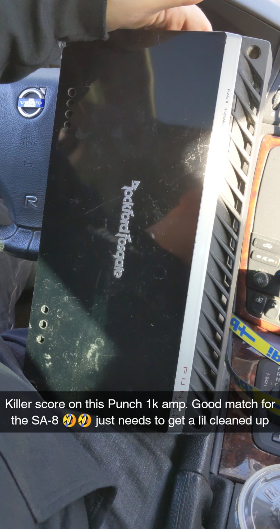

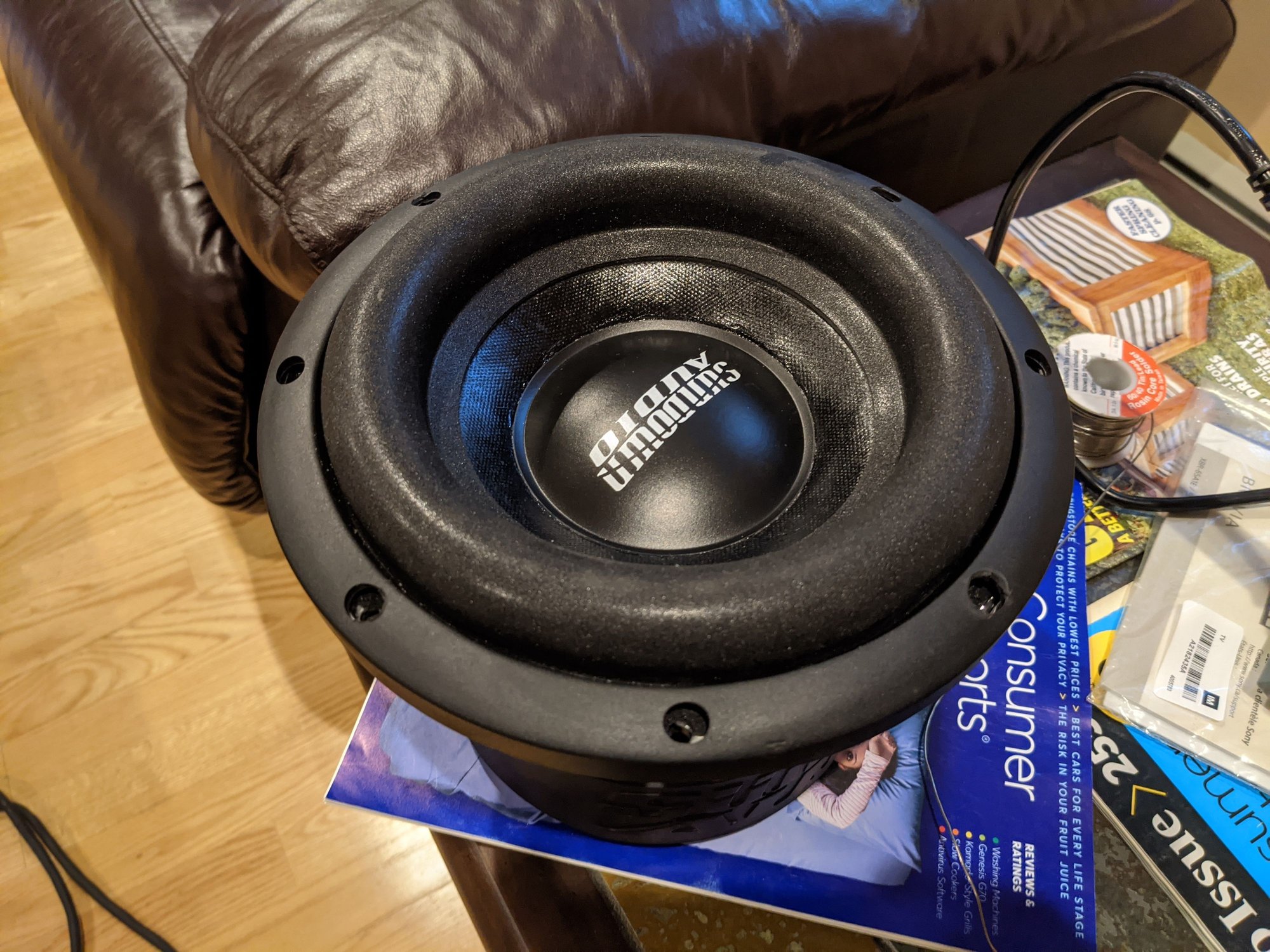

What I will be installing:
- Sundown SA-8v1.5 ported maybe a 6th order series enclosure (need to recone it first)
- Rockford Fosgate P1000-1bd so the sub will be wired at 1 ohm.

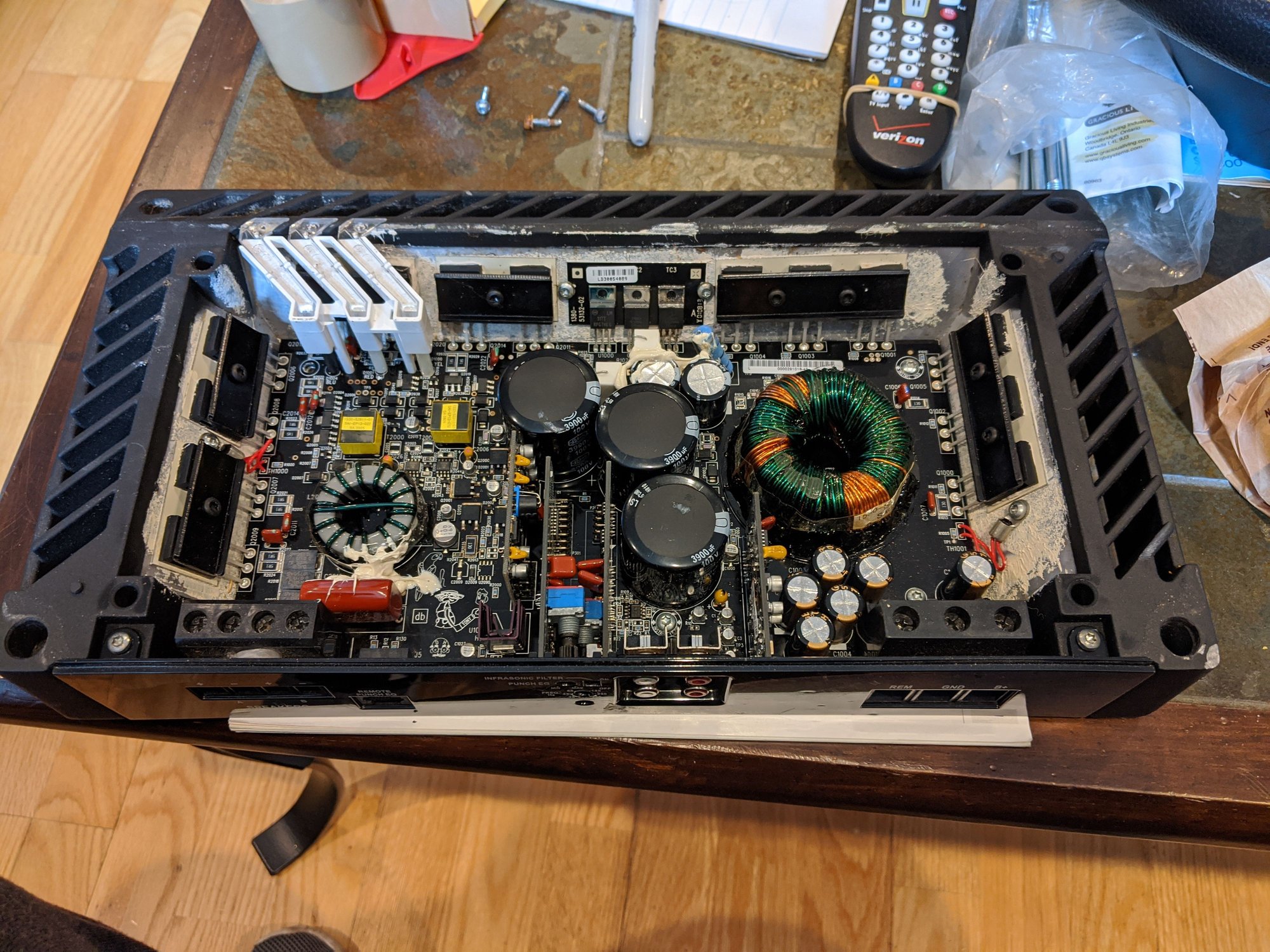

Found no output from the amp. After diagnosing, I found a bad transistor that regulates voltage, bad zener diode, changed the output filter cap to a new one, also found a bad solder joint on a resist. She sings now. Actually not going to use this amp. I picked up a Rockford T500-1bd for a good price that will be powering the sub.

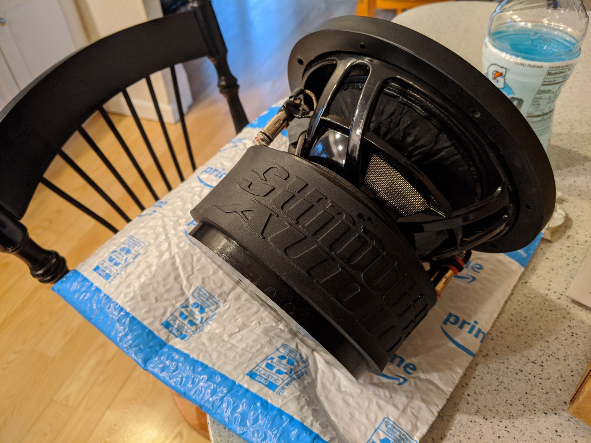

First time recone a sub. Came out good no coil rub.
