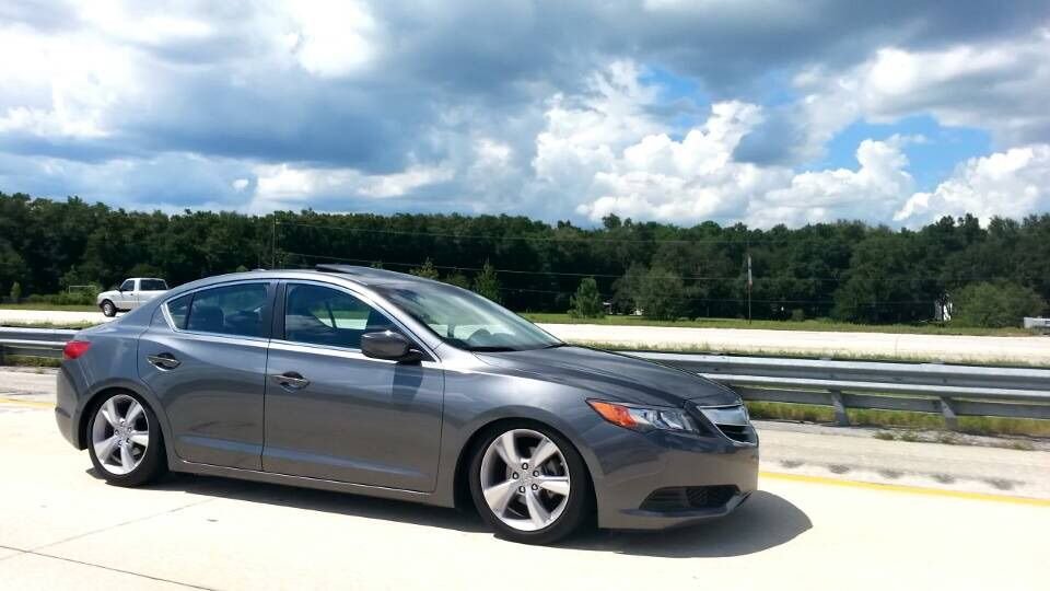

Hey everyone!
I'm new here and I figured someone can maybe help me out. I have a 2014 ILX now I have it lowered on Megan racing coilovers. At the time I got my ILX no coils were offered so with some research I found that 2013 civic si had the same chassis.
I'm thinking about trading in my ILX for a 2016 ILX and was wondering if they have the same chassis? If anyone knows it would help greatly.
