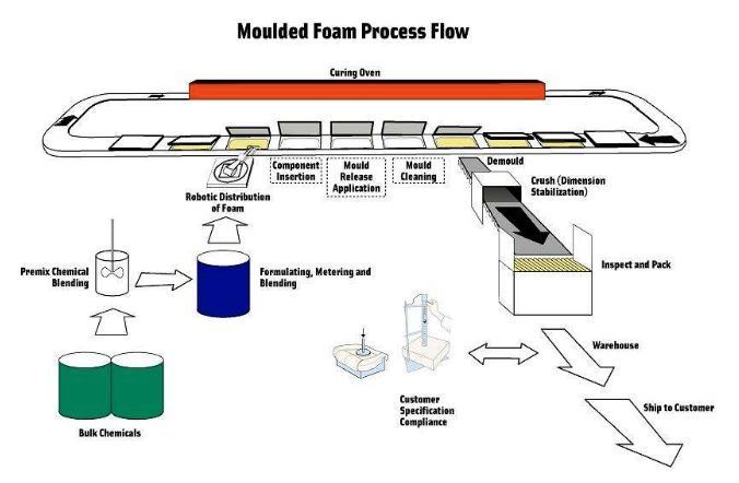

Seat foams are machine made from a mold. There is no human employee stuffing padding into a seat or hand cutting the foam. How would a "crappy employee" cause the seat foam to be missing padding?
Once the seat foam is made, it is shipped to a factory where the seat is assembled.
After that, it is shipped to Honda where an assembly line worker puts it into the car.
Oh well.
