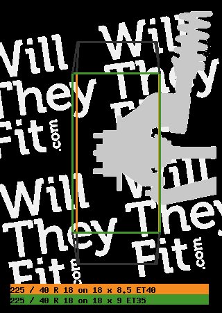

Le, as OSU is trying to say, 9.5 is very wide for a honda/acura.
OSU looks very flush on 18x8 wheels with 45 offset.
^Orange is OSU Green is Aaron.
You can see OSU has little to no stretch and Aaron not only has narrower tires but wider wheels also, making for much more stretch.
You can also see how much further aaron's set up sticks out. Which is about 17mm of more poke than OSU. Aaron fits that under his fenders by running more negative camber than OSU has. Both wheels look the same where the tire gets close to the fender but aarons wheels are wider and will stick out more from the car near the ground.
One is for looks the other is for performance. Im not sure if OSU did any fender work, I believe not where as I believe Aaron did.
Le, ditch the stupid concave idea. Im so tired of concave this concave that. RE30s are gorgeous wheels and will remain gorgeous with or without the concave. I see people who want that concave look ditching the idea of legit wheels for some lame XXR concave BS.
The RE30s in 18x8.5 +40 with 225 tires would be a great daily set up. Not concave. But if concave is all that matters I have nothing left to say.

Old Feb 12, 2015 | 05:29 PM
usdmJON's Avatar
Joined: Apr 2013
Posts: 6,511
Likes: 849
As for that picture I posted it is from will they fit. Com
You can enter in two wheel/tire sizes and they'll make that diagram for you.

Ok guys, back for round 2! What is the consensus for running 18x9+35 wheels on 225/40/18 tires?
If I compare to the spec suggested above, 18*8.5 +40 with 225/40/18 tires, here is what I get:

I'm probably going to go with 17*8.5+32 once I save up a bit for wheels + tires. Should be totaling ~$3k CAD for the setup so I'll be running stock for a bit :p
Will the stock 215's look "hella stretched" on 8.5? Maybe I can get away with running the stocks slightly stretched on 8.5 until they're worn out and get proper 225/45/17's.
