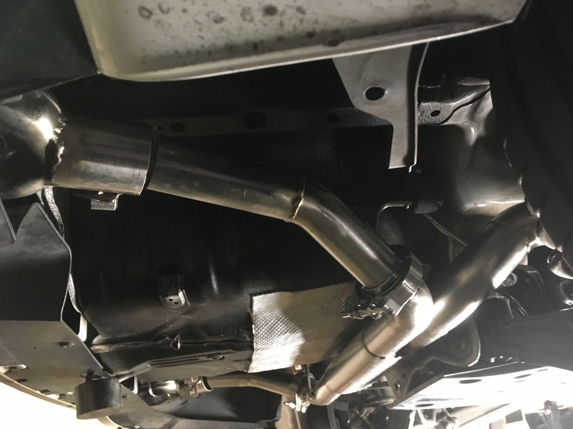

I built my own cat-back system (excuse to learn TIG). All 304 stainless with Varex valved muffler for quiet/loud switch.
Here's my progress thread https://acurazine.com/forums/ilx-pho...inally-956986/

The only science applied was for 2.5"+ and tune for sound.

I used a rotary grinder (like a dremel) with a bur. Fairly easy even with my arthritic, shaky old man hands.
The hardest part was matching left to right.

I cheated. I traced the tip to the insert and cut the holes, then mounted the tips.
The tips are body mounted, not attached to the exhaust pipe. If your tips are mounted to
the exhaust, the heat and vibration will transfer and rattle and possibly melt the plastic around them.
Notice the gap.
