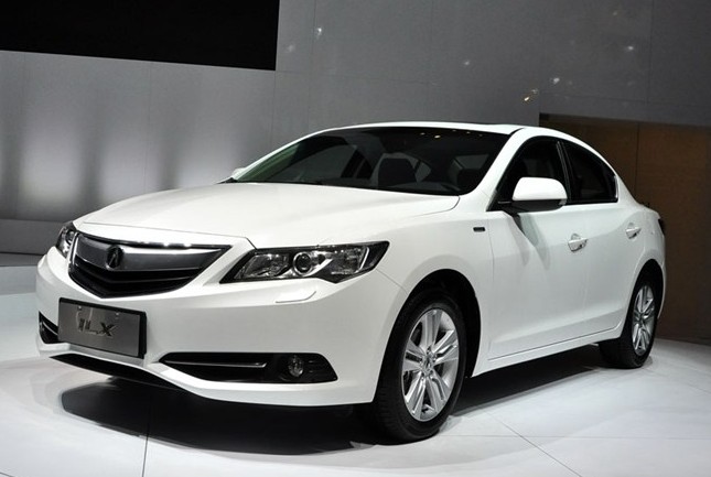

Daytime Running Lights
Hi guys. Just to start off. I am a big fan of DRLs. I love the BRZ's headlights. And I actually want something similiar to it. I have no idea where to get that LED bar though. I have tried searching for it, but nothing has come up. Sorry, I am very new to modding. The most I've done is tint...Oh and if you are driving a White ILX. Black tint is beautiful. What I am talking about is.
or

Might be a while before you see any ILX specifics pop up.
Keep in mind the modding community of the BR-Z/FR-S took off @ day 1.

Good luck trying to duplicate that. After market led strips look horrid:
Also, the drls run on the same bulb as the high beams, so you'll inadvertently disable use of the high beams by swapping for led strips.

You can always just opt to replace your current DRL/Highbeam to be a different color.. or just go white.. I like white DRL personally. Over the LED strips and things of that nature at least.

Yeah I was planning to go 5ks.
Oh and that looks great Switt.
But what I'm looking for is the "bar" look. Like you can't see each individual bulb. Like the BRZs.

To create the bar look from the individual LEDs all you have to do is put a piece of frosted acrylic in front of them.
Also, you did see the end result of his build right?
From a distance they look pretty close to the solid bar to me.
