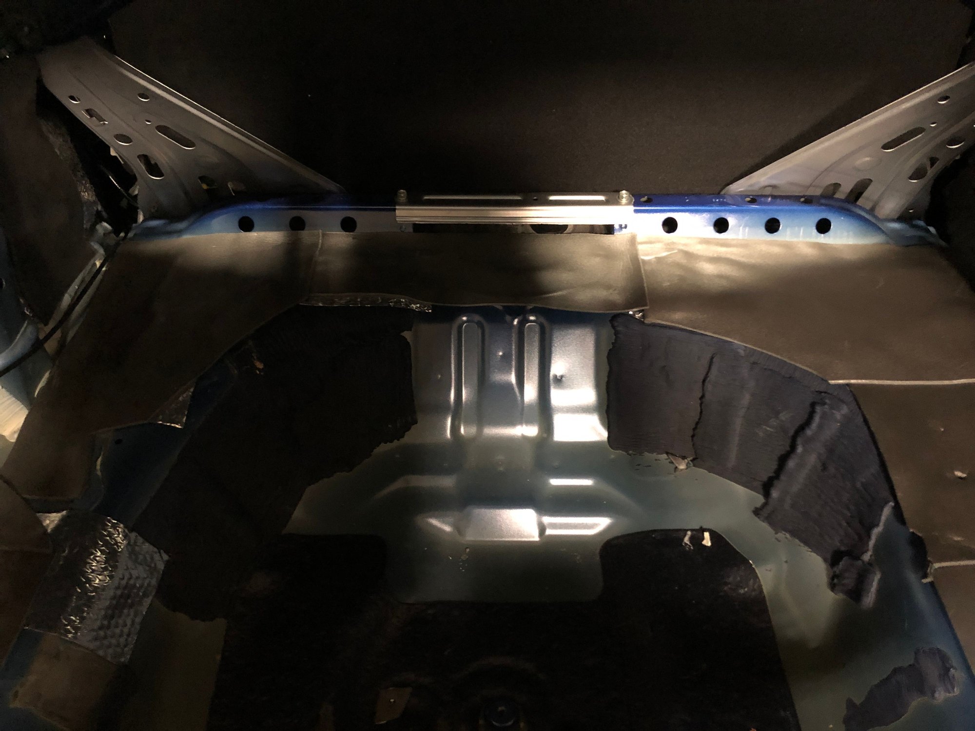

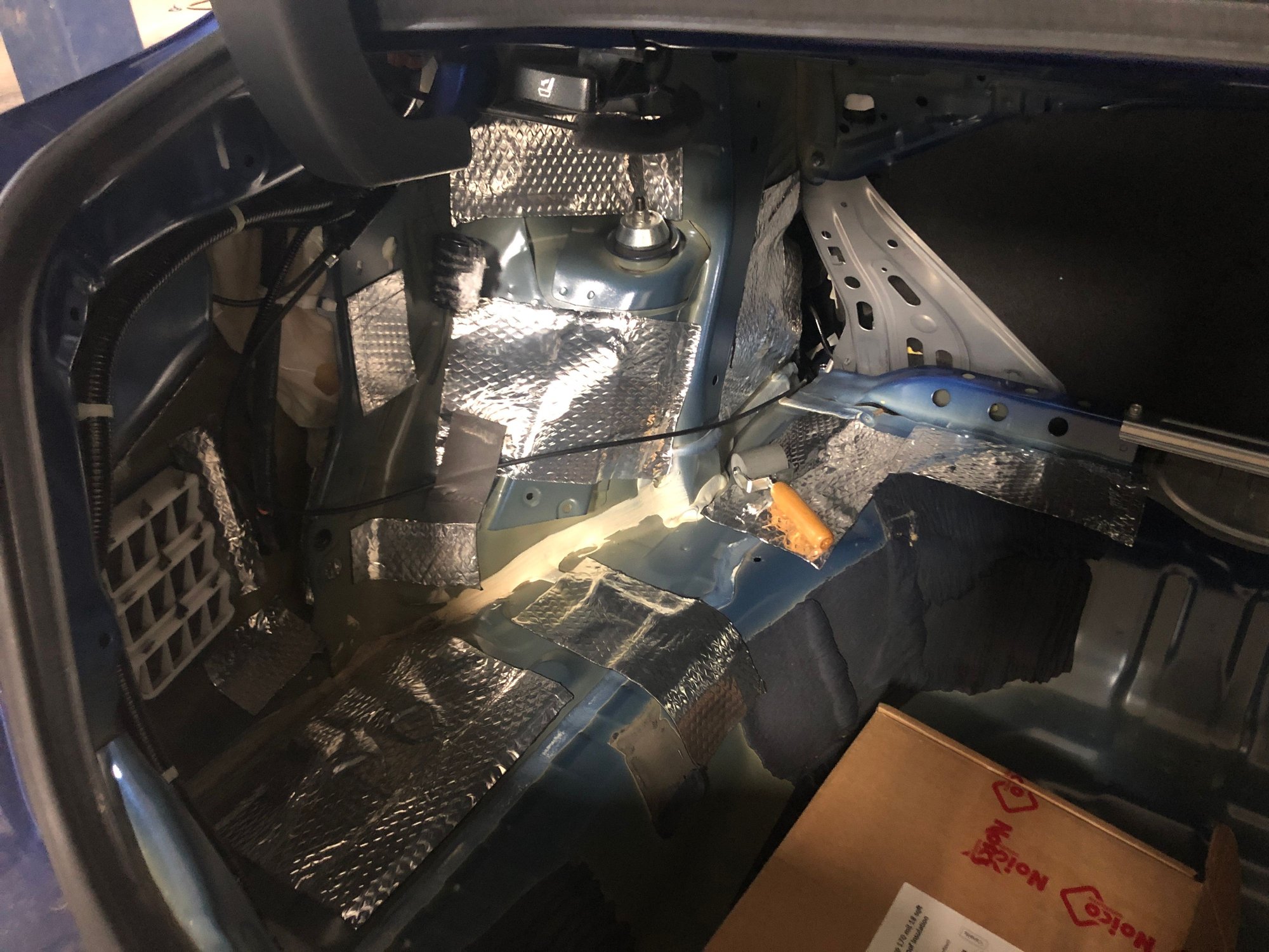

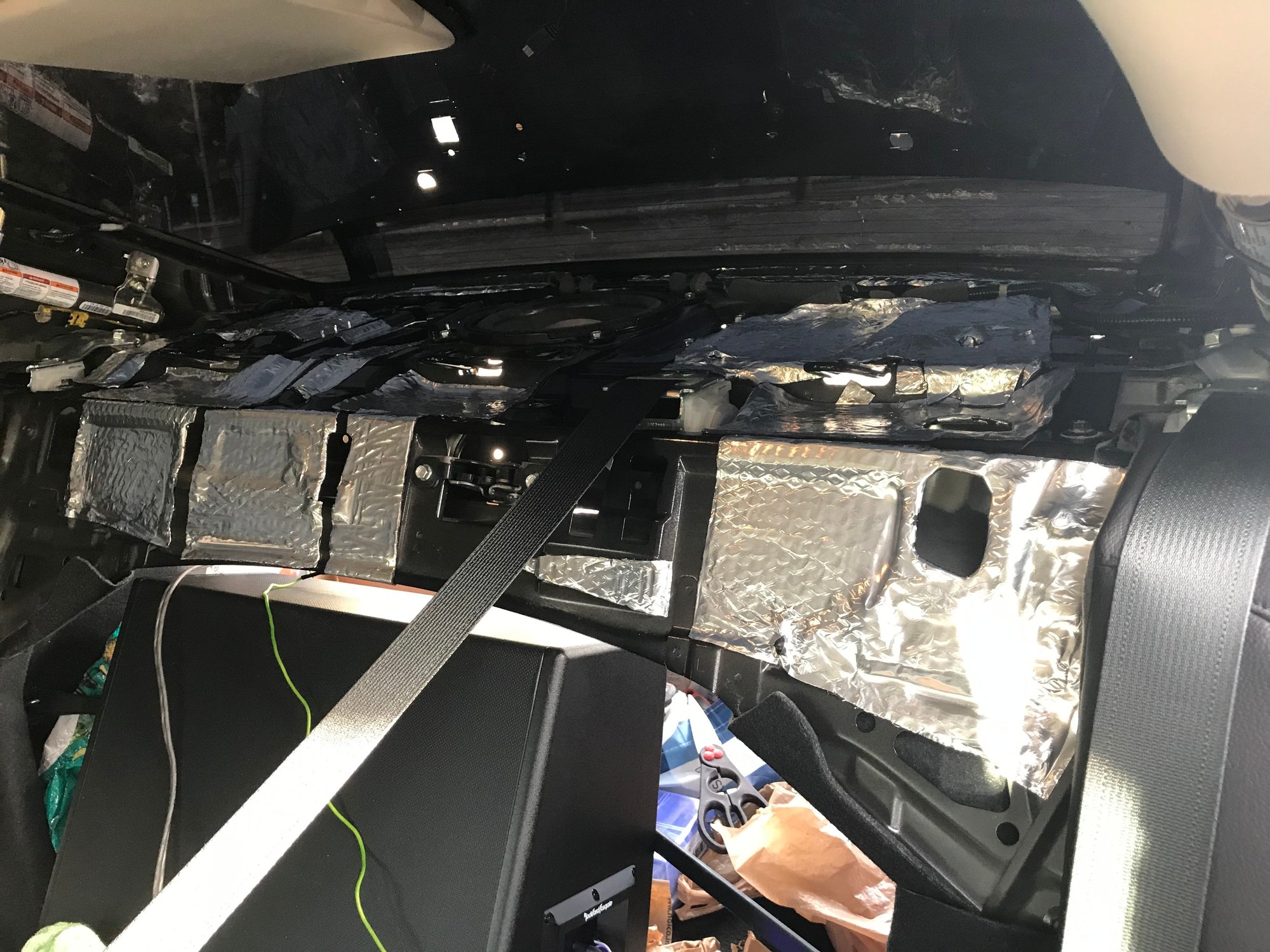

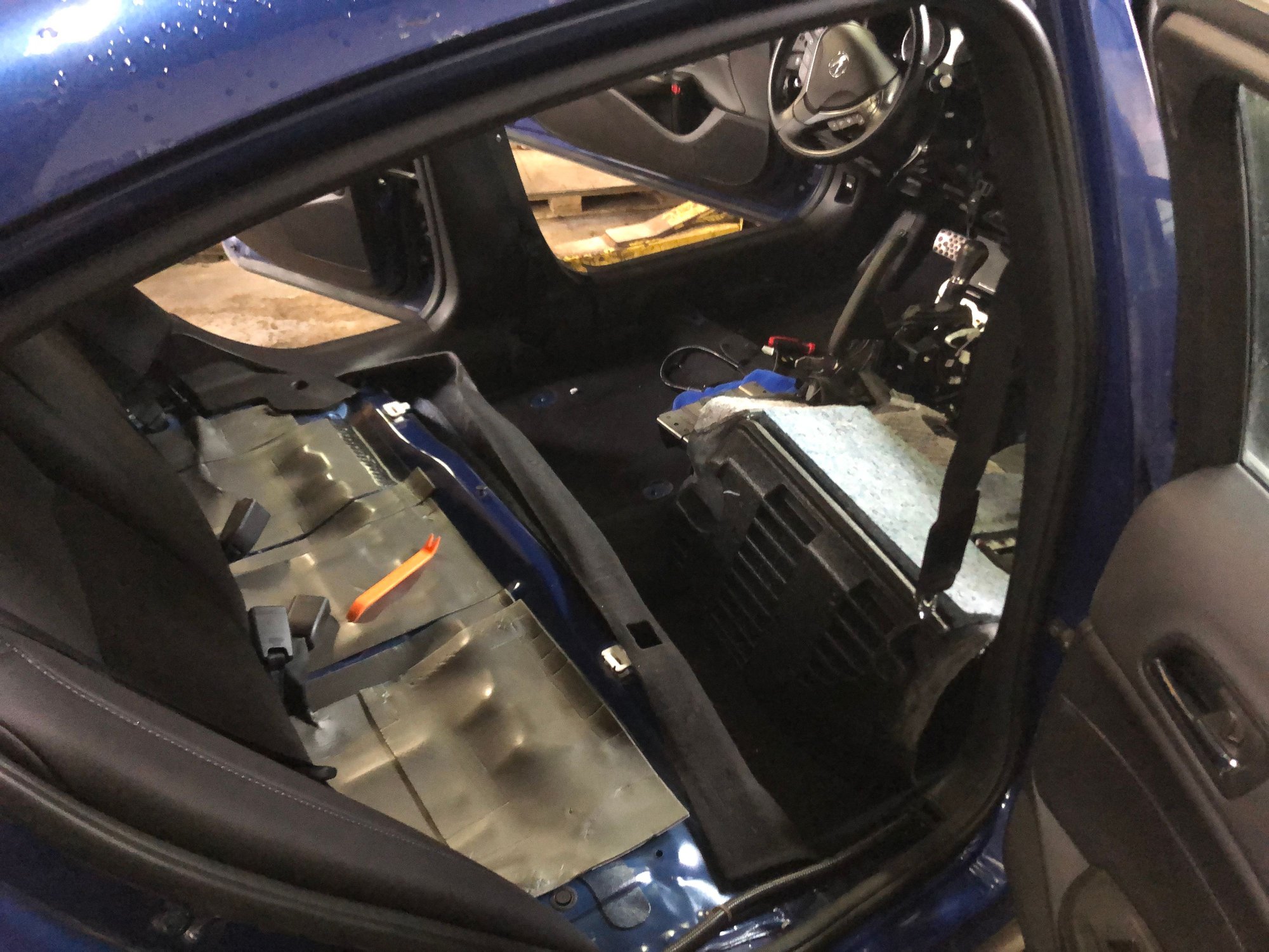

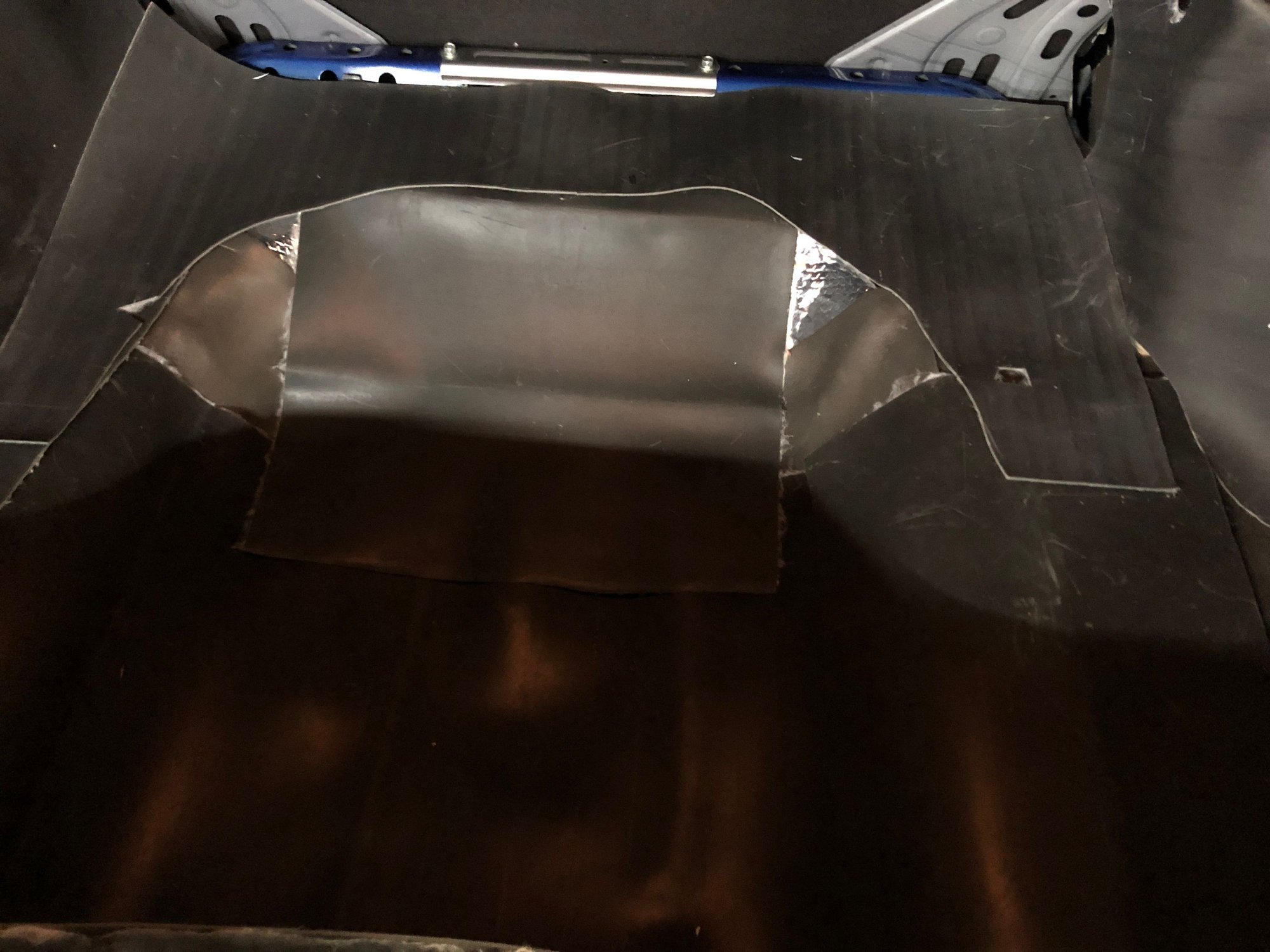

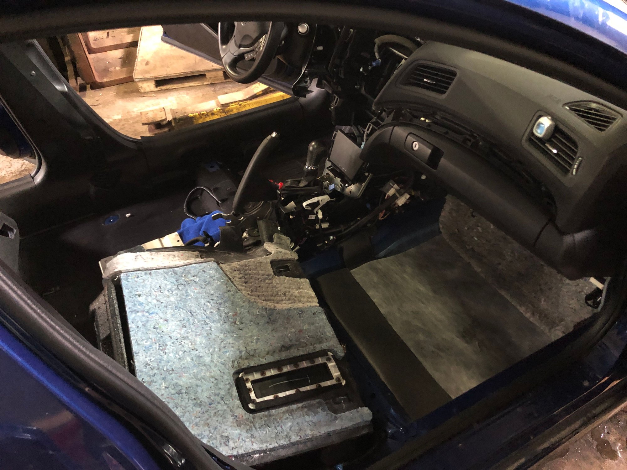

a couple of weeks ago I tried to install some sound deadening material. I did the trunk first and the whole interior subsequently. I did not take any measurements. The most obvious thing I noticed is how sturdy the car sounds when going over rough surfaces. I did it in a rented garage space, so I did not have enough time to document everything. The trunk took me around 3h and the interior 7h30.
I added some Noico sound deadening material, layered with Noico green closed-cell foam, and on top a 1/2 lb/sq.ft mass loaded vinyl. I'm not sure as to whether I will do the doors or not.

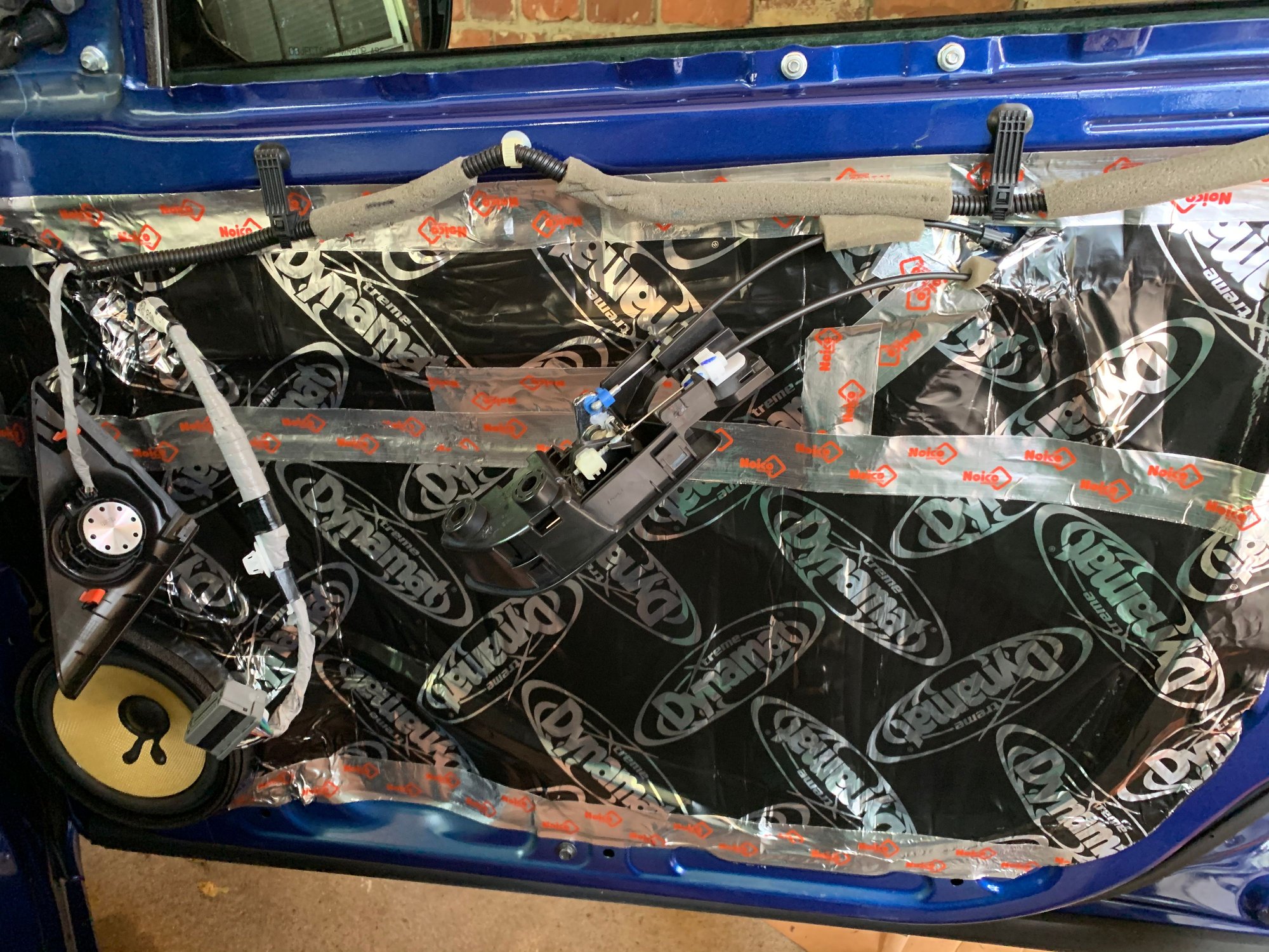

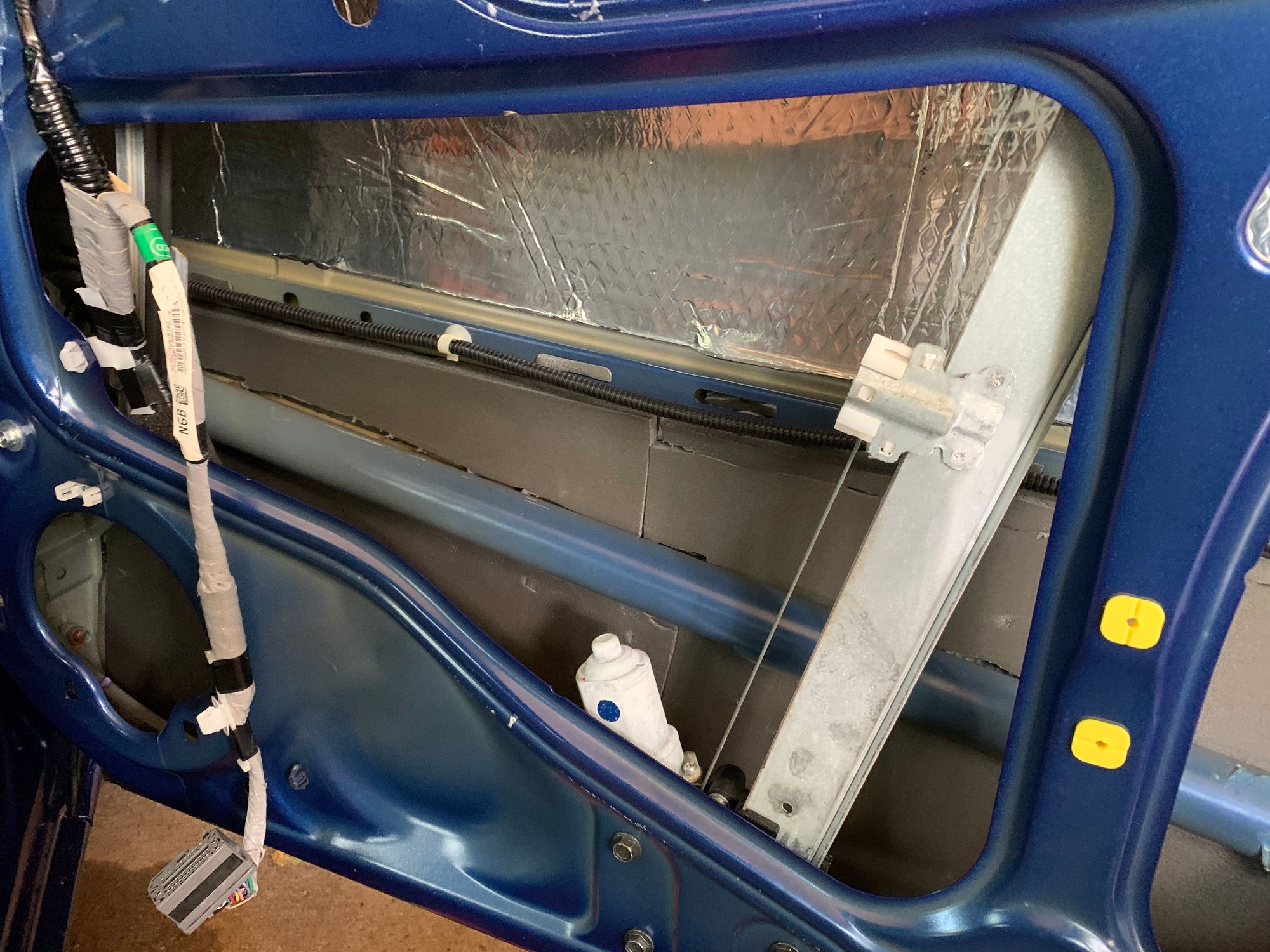

I did similar sound proofing on my doors and trunk and got a considerable reduction in tire noise (and the sound system sounds better too!). I installed 80 mil butyl and 315 mil closed cell foam on the exterior shell and covered the interior openings with a Dynamat kit (see photos). I haven't done the floor of my interior, just the doors so far and I'm really happy with the outcome! It was pretty easy to take off the door panels and remove the factory installed "sound proofing". Kind of hard to work in the small spaces on the exterior of the door shell, but not impossible. I'm thinking about doing the hood to see if I can reduce some of the engine noise as well, but overall the engine noise doesn't bother me.
Interior of Passenger Side Front Door. Installed 80 mil butyl and covered with 315 mil closed cell foam.
Covered interior of door shell with dynamat door sound proofing kit.

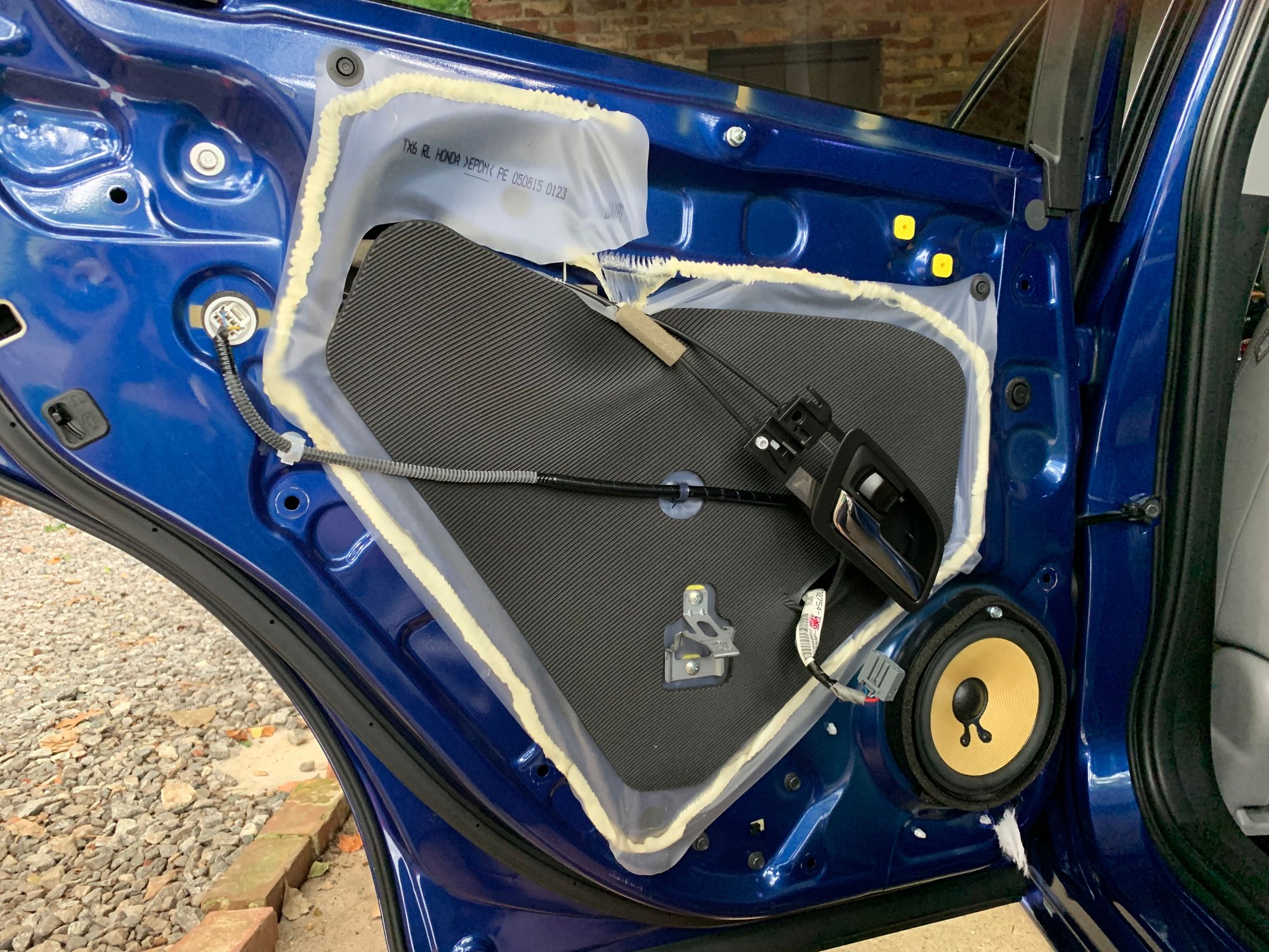

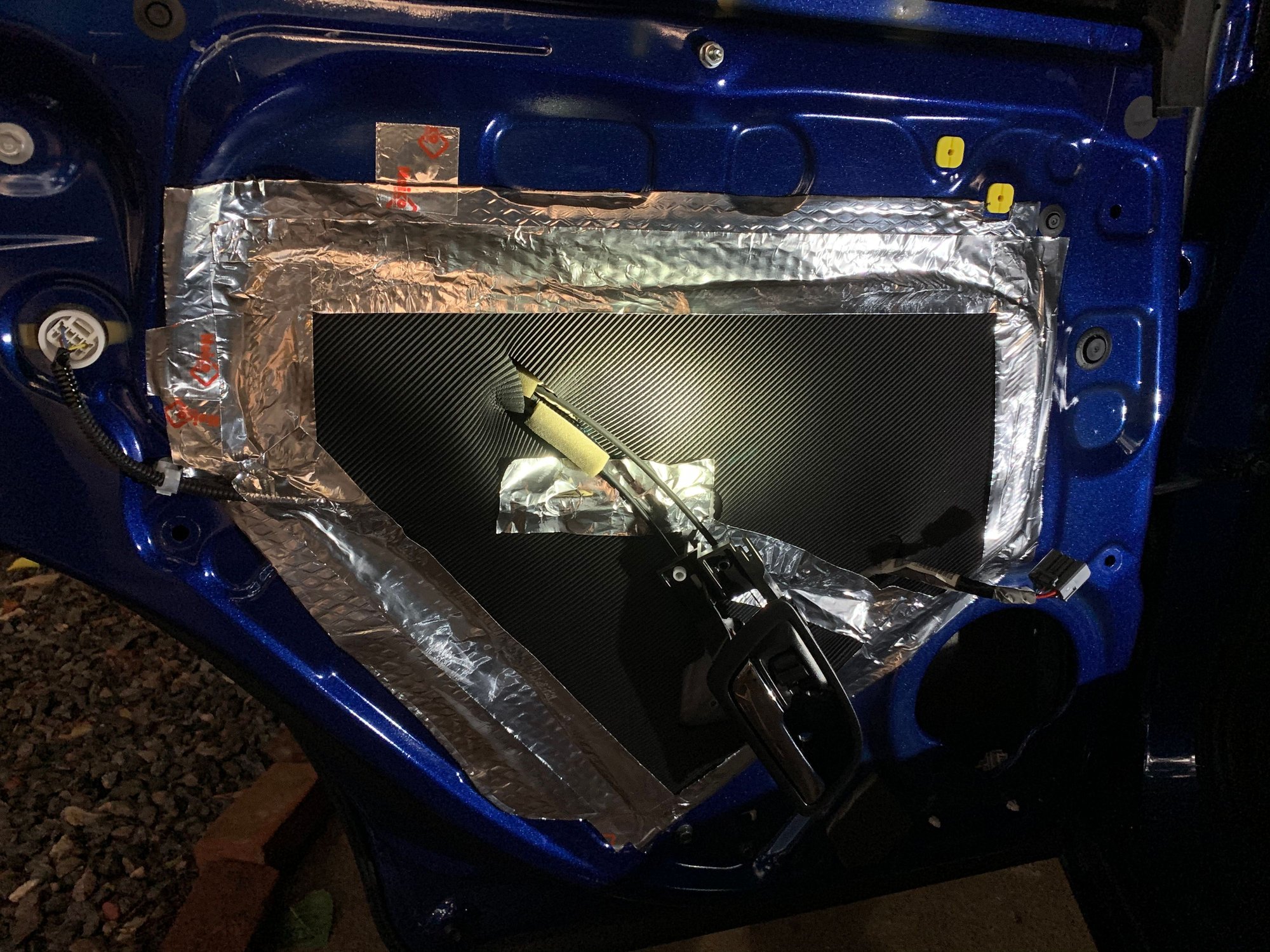

I would imagine doing the doors will give you the most noticeable difference. The only factory sound proofing is a super think piece of black foam that is glued in with a thin piece of white plastic! The doors are basically thin metal echo chambers without additional insulation. The speakers also sound so much better once I did this! I have the factory "Premium" sound system with 7 speakers and without any other modifications than the sound proofing, the speakers are louder and clearer. I can feel the bass out of the door speakers and I turned down the bass setting and listen to it at the same volume. My main complaints with this car were the tire/road noise and wind sounds (particularly at higher speeds or on the highway). Between the sound proofing I've already done and adding additional weather strip around each door, I've drastically reduced the tire/road noise and basically eliminated the wind noise! I'm so happy with the results and plan to keep the car for as long as it will last me.
Factory "sound proofing"
I did reuse the factory foam mat over the dynamat, simply cut off the white plastic and used tape to reinstall.
