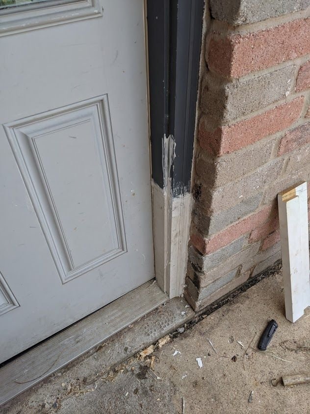

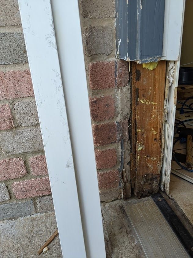

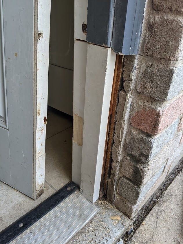

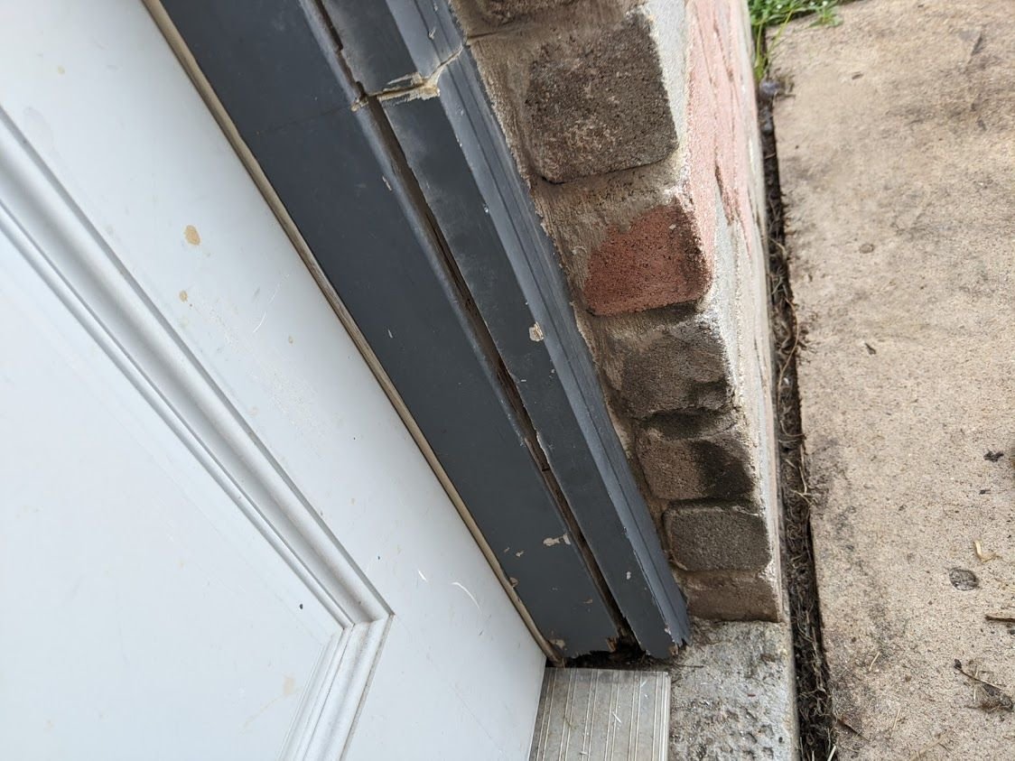

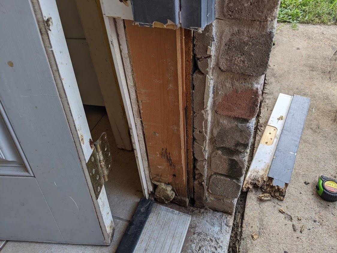

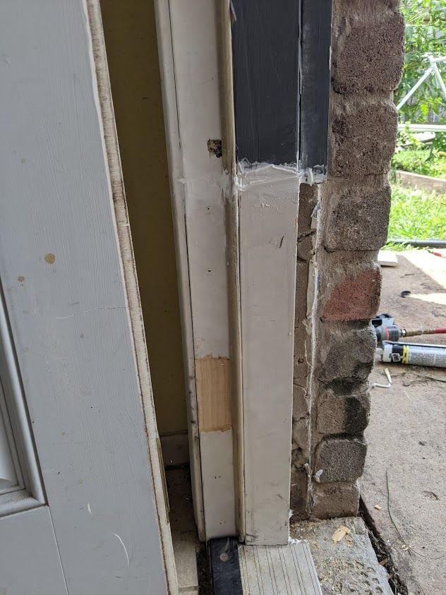

I just did this repair a few months ago to my back door.
I am by no means a carpenter. I enjoy working with metal more than wood because metal is more forgiving. Carpentry generally has to be more spot on.
I decided to cut the rotten pieces out because I didn't know my skill level. I didn't know if i was able to replace the FULL frame in one day. An experienced carpenter would tell you to replace the full frame and have it done in an hour or two. I totally didnt want to mess up and have the door open for a day or two. Because I just didnt know my skill level. I just didnt want to fuck up and have the house exposed to the elements for a day or two.
cutting the bottom seemed like the better option to me....I could still close the door. lol
I went to youtube and home depot and learned that home depot sells the door jamb and the brick molding. in the exact shape of my existing brick molding.
bought enough material (door jamb and brick molding) to do both sides and a little extra just incase i mess up
in Houston, we get sideways rain. water will always beat against the brick molding which causes it to rot.

That looks like a good job. Yeah, that's what I saw people doing on YouTube, more or less. Hate to be nit-picky, but on the ninth picture, doesn't it look like the interior wood (I guess that's the actual frame of the house) also has some wood rot at the base? I know you can't do anything about it now, but it's a little worrisome.
Anyways, my point is I was worried about security. Like having half of the frame replaced can't be that solid, can it? Don't you worry that someone could just bust it down now? Not that they'd know that your door frame was in two pieces, but still.
that was my worry as well, what if the frame of the house had rot. my house is 30+ years old.
and no, it's some kind of black adhesive. I think this is the 2nd time we've replaced the door frame in the 20 years that I lived here. So, who ever replaced the door frame used some kind of black spray in that corner.
For security, one would use long ass screws to screw the door jamb to the frame of the house.
all door jambs are built this way.
and yes, that's why it's easy for doors to get kicked in.

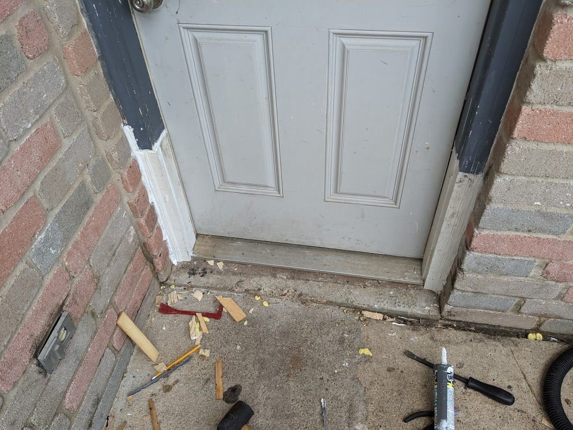

You also need a second weather cover on that exterior outlet, LOL. Actually, you may need a whole new cover bc it looks like there's a gap there.

I bet he went outside with a flashlight to look at his outlet.
Old Nov 25, 2020 | 09:54 PM
that's why I was using the inside outlet to power the power tools.
the whole outlet needs to be replaced.

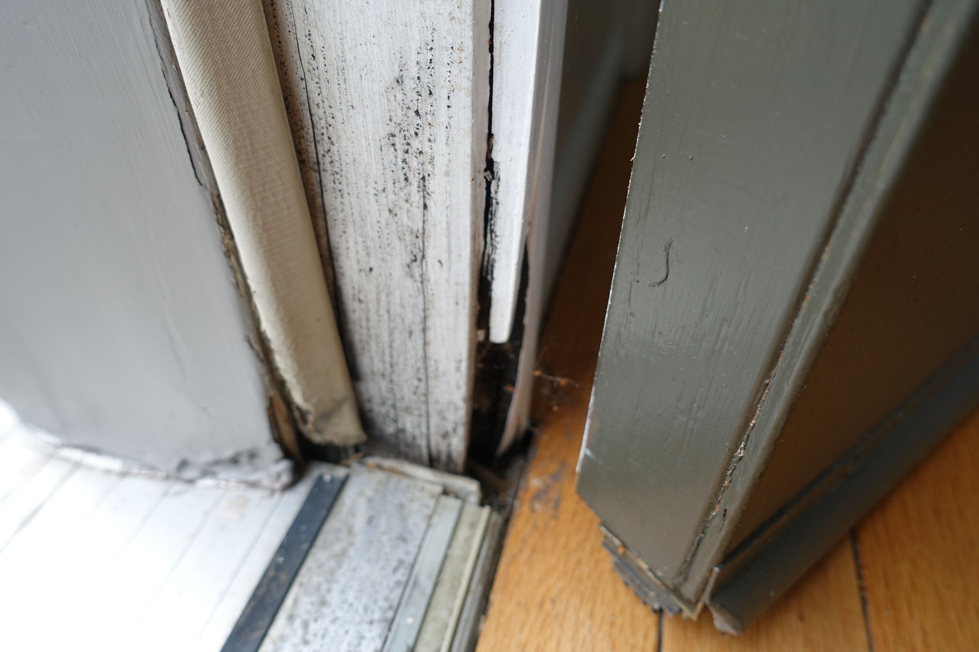

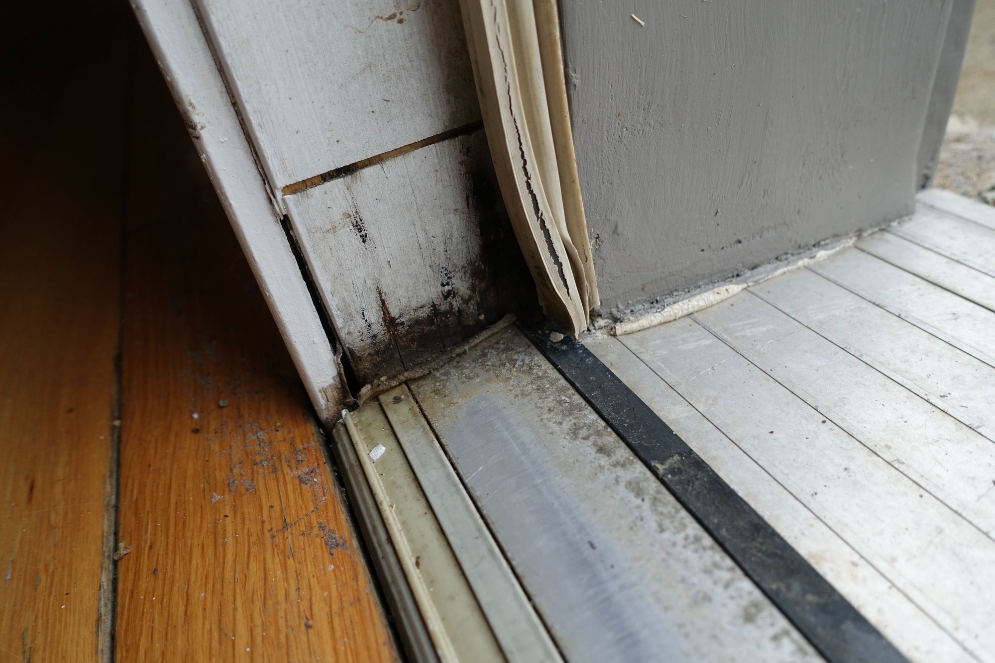

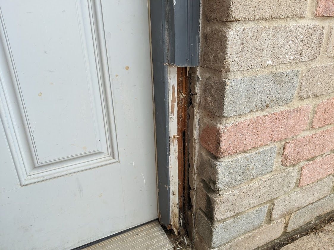

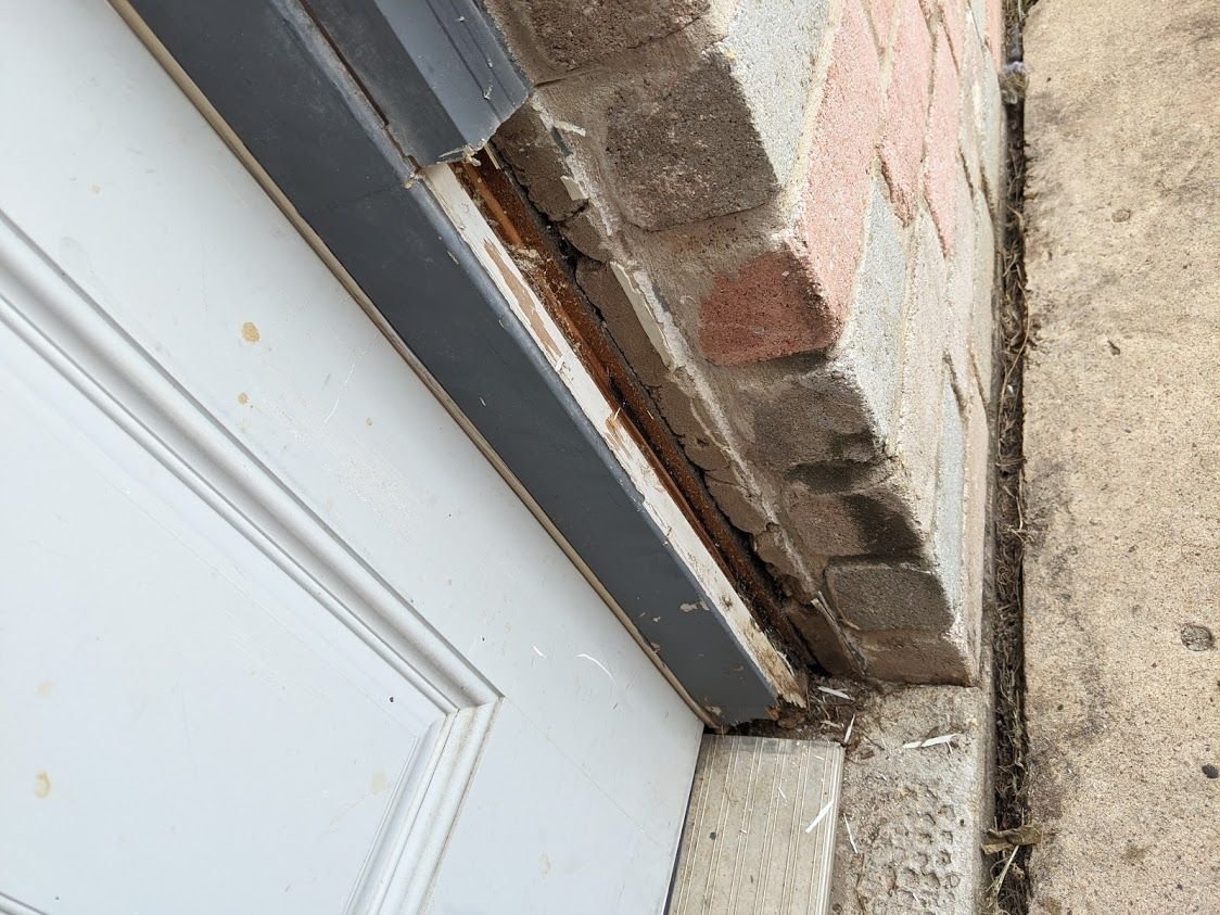

OK, here are the pics. They're not terrible, but like I said there are issues with the glass, too, and the whole door is old. So I'm not sure whether to replace it or not.
One side.
The other side looks like maybe it was already repaired and probably needs a repeat.
You can see all the way through it.

Actually, now that I look at that I have no idea why there's rot on the inside but not the outside. It may be that the base plate was installed backwards, since it looks like the downward slope is facing in and I don't know if that's how it's supposed to be.
That's exactly what it looks like. There's no easy fix for that. Sadly it looks like the door was installed backwards.

I bet when it rains it all comes down that plate. The weatherstripping just stopped it, but the wood soaked it up. You could have other mold there that you can't see. Replacing it all depends on what you are looking for to fix it. If you plan to be there short term, you should be able to patch it. but if you want a proper repair, replace the whole thing. You or a future owner will avoid the same issue down the road. There might be structural issues below that door too so you will probably open up a whole new can of worms.

BTW, I took a closer look at that base plate and it's not installed backwards, it's just a weird base plate that has sloped sides on both sides. The slope facing outwards is longer but shallower and looks like a normal outward-facing base plate. The slope facing inwards is as pictured, short and relatively steeply sloped. I don't know why they did that.
